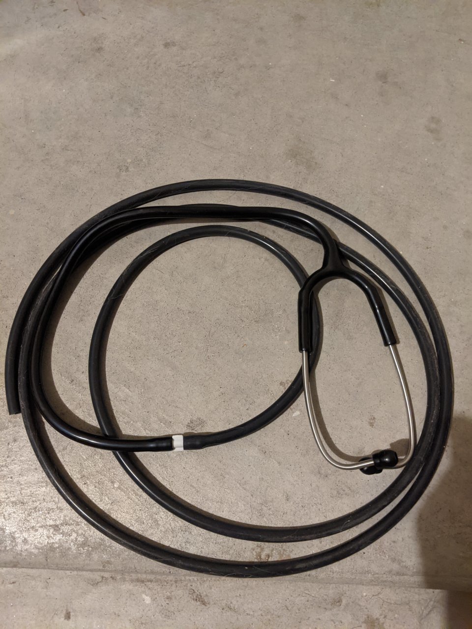

    You're going to find a lot of soot somewhere.
    ^^^This is a very good method. The engine "stethoscope" Many a vacuum leak or exhaust leak can be easily pinpointed with this method.

    Had an old stethoscope laying around from my Medical Assistant program lol removed the bell/diaphragm, threw in a plastic connector and attached another bit of hose. Will finish my morning coffee and then figure out a more appropriate length to cut that extra hose down to so that it doesn't lose too much sound along the way. And it give it more support when moving it around.
    If I get extra bored, I'll probably wrap it in electrical or duct tape to make the hose stiffer for future use. Lol

    Looks like it should be the passenger turbo-DP connection.
    Badass suggestion with the stetho/hose guys, thank you. I'm keeping this contraption in my workbench now lmao didn't even cut down the hose, didn't need to.
    Placed it on the various connections and everything was super quiet, hardly any sound. Pass.Turbo-DP was turbulent as fuck though, sounded like helicopter rotors lol driver side was nearly silent by comparison.

    This is great news! The bolts to that D.P. loose?

    When you check and adjust the DP>Turbo, check that the flange for the DP is aligned with the turbo housing. You can see on the bolt holes it allows some vertical travel for aligning it.
    hopefully that makes some sense...
