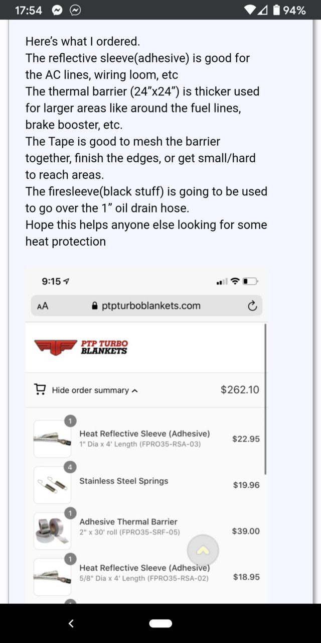

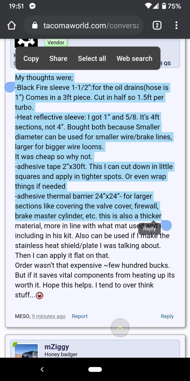

    Going to want plenty of additional heat shielding stuff as well.
    Also got turbo blankets for the snails. The specific ones are buried in posts somewhere in this thread. @deuceb

    I think I've got everything you do as far as heat shielding he's set.
    It was basically a copy of Meso's order, about 500+ worth of stuff from PTP.

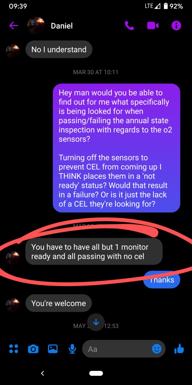

    So my p0430 CEL (should be driver's side since it looks like cyl 2 is on the driver side?) keeps intermittently returning. A few days of driving with it on and it'll go away for 5-6 days, then returns for a couple days, rinse and repeat.
    The screenshot below is from my buddy who works at the local dealership, was asking about passing state inspection.
    Since turning off an o2 sensor in the tune (setting the numerical value to zero) places it in a not ready status, it appears this method could clear up my issues while still letting me pass state inspection annually.
    But because it's a numerical value (normally 250 I think?) I wonder if a lower value (not zero) just makes it less sensitive and keeps it in a ready status?

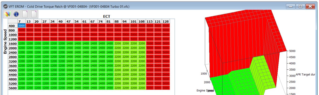

    Currently I am working with @Turd Hawg for final testing on another persons truck, so that we can release these files.
    as soon as we wrap things up with turdhawg, we are good to go
    Our Cold Engine Drive Patch works very very well.
    how it works is simple. Depending on the Engine Coolant Temperature, and the Engine RPM, Throttle is limited.
    This allows you to drive safely at cold engine temps, while limiting total boost and torque, until the engine is up to temp.
    It eliminates ***multiple*** issues with driving and boosting on an ice cold engine.
