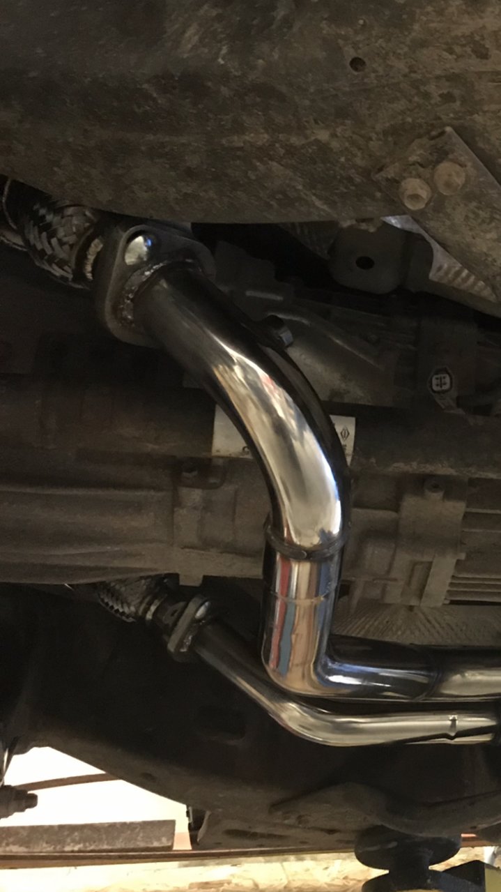

    I think I've found the source of my intermittent p0430 (driver side) o2 sensor code.
    So, with the bolts as tight as I can possibly get them, there's just the smallest gap on the bottom lips of the flanges where they should meet. Some soot there too. Shifting the y-pipe while tightening helps but isn't enough.
    I'm thinking then that the Toyota gasket inside, which sits in the recess around the hole and is supposed to allow the two flanges to come together and seal, can't do enough to create a full time seal and some air continues to get through.
    So I went ahead and ordered more of those Remflex gaskets, the 2.25" versions (turbo-DP is 2.5") and I'll use those to create a good seal throughout the entirety of the flange surfaces.

    That is what I used on my setup. Have only idled the truck, but didn’t notice any leaks.

    The Turbo hotside to downpipe gasket (the graphite one) there will be a tiny little gap, because that gasket is thick

    My turbo - DP connections are fine.
    I'm talking about DP to Y-pipe. The sensor that gives the CEL is located right after that connection, and that's where I appear to need a full flange gasket rather than just the little donut piece that would normally be there.

    Those Remflex ones are the same gaskets I ordered and will be putting in. The kit uses the 2.5" version up top at turbo to downpipe
