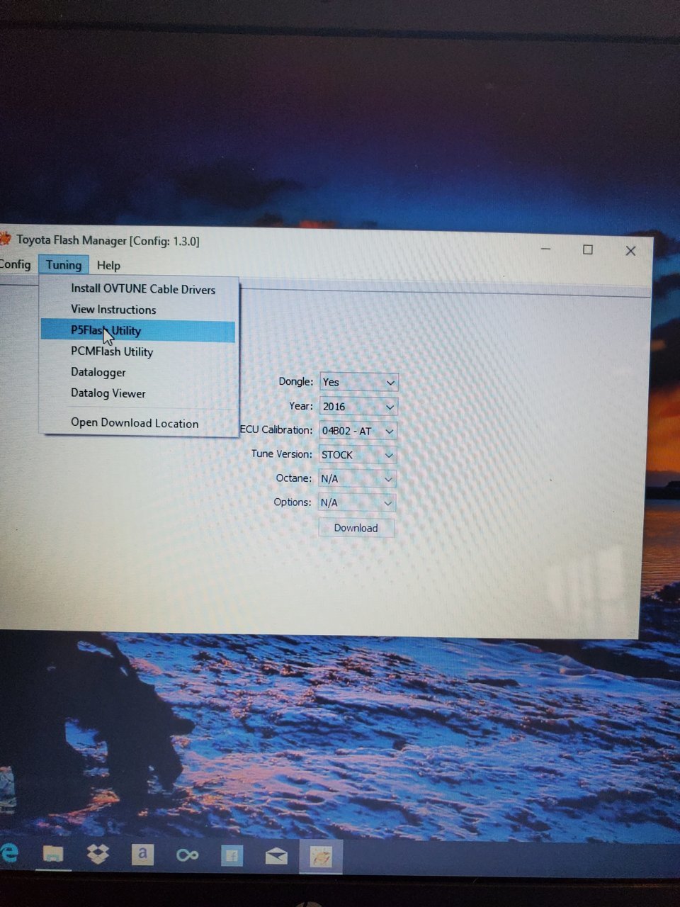

    Ok. From this screen, I'm supposed to be able to see my system ID. Nothing is coming up.

    Did you click on P5 flash utility?
    https://cdn.shopify.com/s/files/1/0885/5830/files/Tacoma_NEW_instructions.pdf
    According to the instructions its supposed to bring up another window called "ToyFlash" which should have your ID. If the window doesn't pop up, the instructions say to disable your anti-virus AND windows defender.

    This is where its stuck. From P5flash nothing happens. No other screen comes up. Now I'm trying to find a way to allow the virus protection on the computer to let it run.

    Yeah that's probably the issue then... Anti virus or defender is preventing it from popping up.

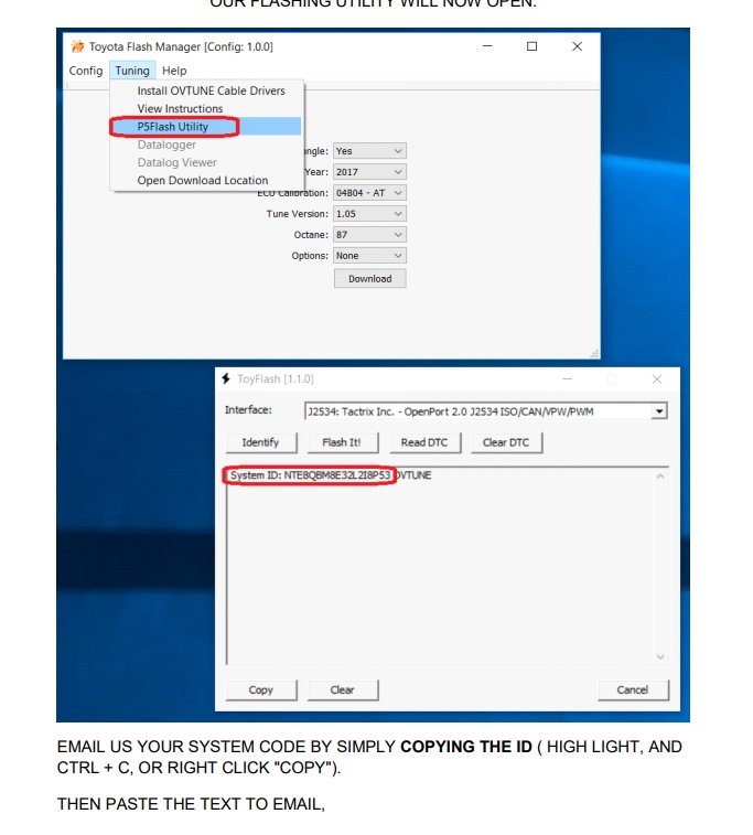

    tony
    Lynnwood, WA
    I saw this, but was unsure where the OP was stuck. With his post below, I can help a bit.
    This seems to be all that you need:
    Can you do a screen dump after this?
    Also, did you do the Purge All Data and Update functions? See 1min into the video here:
    https://www.ovtuned.com/pages/tacoma-3-5-flash-kit-instructions
    Be sure that you have all antivirus turned off for the initial installation including malware and ransomware. After the installation is complete, turn that stuff back on and allow anything that pops up when you launch the OVT software.
    All tuning programs like this, including TechStream act like viruses but are completely safe.

    I dont know what a screen dump is. :-(
    Matt has replied to an email and I think/hope I found the I.D. I'll know for sure if Matt comfirms this.
    Def seams an antivirus was causing frustration to this point.

  19. Jan 13, 2020 at 7:50 AM
    #19
    tonered
    tonered bartheloni
    Sep 25, 2017
    #231055
    30,553
    tony
    Lynnwood, WA
    Screen Print, Screen Shot, Print Screen. All the same. Like the pic that you posted above, but there are easier ways than snapping a pic with your camera. Try the Screen Print key, then just Paste it into the TW posting window (CTRL+P).
    Or, Shift+Win Key+S (all three at the same time) for the Snipping Tool and then paste.
    The System ID should look like I posted above, with the words System ID.
    Just turn it off for the time that you are dealing with the OVT installation. Don't be afraid to uninstall and start fresh. Always do the Purge and Update steps. I have no idea how the HHs work, but you'll need to install those drivers when you get it.
