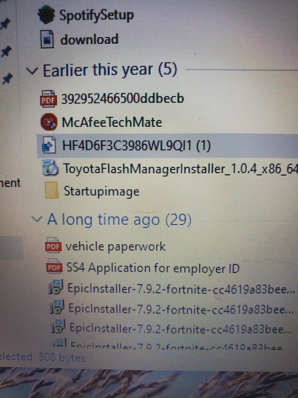

    I think this is it. As stated in the download folder.
    Same time frame as the FM. Ill give it a shot when a friend of mine can help me out

    Yes ..... I believe you've found it.
    HBJSJVSFE63036Jxxx.reg <-- This is what mine looked like

    Nice work! Great job, @Shellshock !
    Save that somewhere.
    It looks like you will be set to go.
    This is important stuff. You gotta hold that computer for random. :D

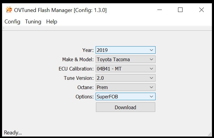

    Ok...new FM is installed and old one deleted. Is there anything else before looking for tunes and flashing the truck? I couldn't find any new walk thru videos on ov websight and disnt know if old ones still applied. Any update? Anything? Getting close to go time

    If you open FM, no buttons are grayed out? Just checking before go time. :D
    For the MTs, it is the same as before. Download the new tunes in FM and flash it up! 2.0 SFOB is the tits.
    It is recommended to Reset the DTCs and Learned Values after you flash, so:
    -- Flash
    -- Once complete, start the motor briefly to test.
    -- Shut the motor off and then turn the ignition back to On, but without the motor running.
    -- In FM, hit the DTC Reset and then the Learned Value (LV) Reset.
    -- Once done (just a few seconds), start the motor and idle for about 5min while touching nothing.
    -- The idle will be a bit rough after that 5min and the first few miles will be a bit wonky, but things will smooth out and be really, really good.​

    I get this...

    Sorry, but that is not what I get:
    Does your Config version match mine?
    If not, try Config / Purge, then Config / Install All Software:
    Then, Tuning / Install OVTune Cable Drivers:
    And finally, Help / Update:

    My buddy showed up, offered more help and WE ARE DONE!! Everything says completed and successful!!! Letting it idle then will drive
