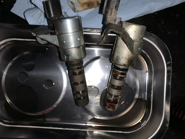

  7. Sep 25, 2020 at 10:30 PM
    #47
    hresendiz25
    hresendiz25 Active Member
    Aug 17, 2018
    #263148
    27
    Horacio
    Arizona
    2009 Toyota Tacoma 4x4 Double Cab
    URD Fuel Pump
    Thank you guys!
    Well, I think I created a problem for myself by just going with aftermarket parts. Swapped the OCVs back to the originals, I didn’t even need to clear the codes. Once I reconnected the battery my dashboard was clear. I have been driving all day today and no codes. Just returned the darn duralast items.
    Go OEM with sensors everybody.
    Here a couple of pictures as a reference (OEM to the right) Both seem to be exactly the same
    For some reason the website rotates this picture. I moved the OEM to the left here (or bottom), but tried to place them at the same angle position based on the sensor. It looks like everything at the bottom (piston?) has a different angle. Don’t know if this would make a difference though. Thought on sharing.

    Glad it's back to working normally. The aftermarket part was probably made by a chinese political prisoner, using a pack of matches and his shoe for assembly line tooling.
    While I haven't scoped the oil passages in the engine's head casting it's safe to assume they are linear, not annular as there's not much casting space to work with in there. So having the OCV's oil orifices facing the wrong direction would impede flow to the VVT actuator and reduce its ability to advance cam timing on command.
