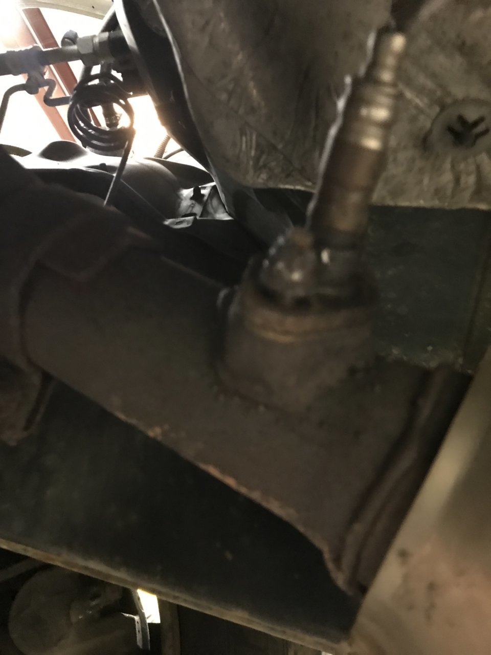

    Can confirm! I just replaced the A/F sensor a week ago after I got the P0125 + P1135 + P0171 and the check engine light did not return after a lengthy test drive. One of the key signs is that it's a heating circuit issue with the A/F sensor; no heat, no workee. It was Denso part 234-9001 but it didn't come with any fasteners and mine were a corroded mess. I recommend buying a few M8 x 1.25 COPPER flange locking nuts before you start just in case you need to torch and or grind your nuts off like I did mine; mind the studs. old sensor.jpg
