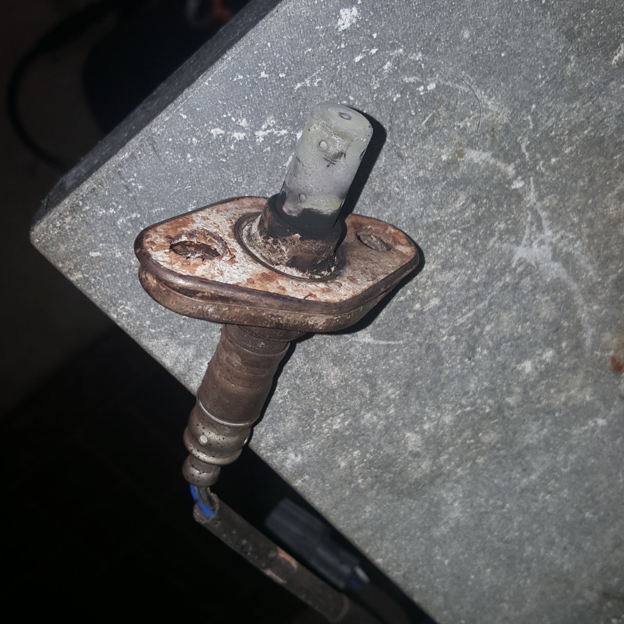

  6. Feb 26, 2020 at 4:03 PM
    Taco302
    Taco302 [OP] Well-Known Member
    Jun 10, 2013
    #105981
    657
    Greenbow, Alabama
    2003 2.7L 5 spd 4x4 xtracab
    Old one out..easier than changing a battery
    Black DOG Lila likes this.

  8. Feb 26, 2020 at 5:33 PM
    Taco302
    Jun 10, 2013
    #105981
    657
    Greenbow, Alabama
    No smell...i was worried about a headgasket leak with the gray/white foul look but oil isn't milky, no loss of fluids and no overheating problems.
    These must be the original sensor bc I bought the truck around 90k miles and it still had the toyota factory sensor until today.

  10. Feb 27, 2020 at 5:08 AM
    Black DOG Lila
    Black DOG Lila Well-Known Member
    Jun 14, 2019
    #296344
    6,741
    Virginia
    2003 Tacoma SR5 2.7 5 speed 4WD
    Stock. EZ pass.Dump pass.Inspection sticker.Convict printed lic.plates.FG cap.
    Never seen an A/F sensor light grey like that. Only tan to dark brown. How's your fuel trim #s? May be running lean which Yoda heads and valves don't like.
  11. Feb 27, 2020 at 4:53 PM
    Taco302
    Jun 10, 2013
    #105981
    657
    Greenbow, Alabama
    I have never observed those values, will have to check it.
