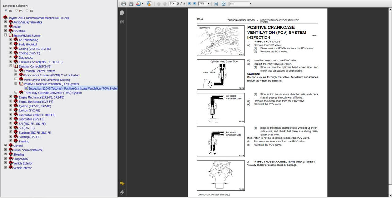

    Well...The 3.4 doesnt have a PCV.

    TIS disagrees
