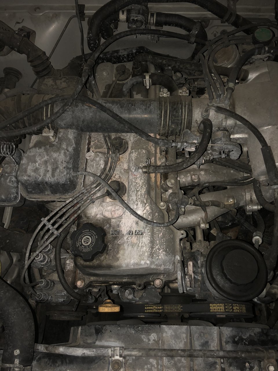

    Heres pictures of what I think you’re wondering? I thought 4.0 meant 4 cylinder. This truck is California emissions specified.

    Looks like you have Federal emissions, those are your coil packs in the second picture that the plug wires are going into. I thought you said you replaced wires? Those don't look new, lol, hopefully that's an old picture.
    I thought you could swap those 2 coils as a test, but it looks like they might be specific to the cylinders. It looks like AutoZone typically stocks their Duralast brand for $68 each and they say it is for all cylinders. You could get 2 from RockAuto for that price, but they have them split for cylinders 1,4 and 2,3, which matches your wires. They do have a Delphi branded one for all cylinders, though. If you can wait, order from RockAuto (they are listed under vendors here on TW and have a coupon code), or get one locally if you can find one and replace that front one, see if that gets you going. Make sure your wiring is good first, though, to rule that out (check to make sure the wires going into the side of the coil pack aren't broken or pulled out of the connector).
