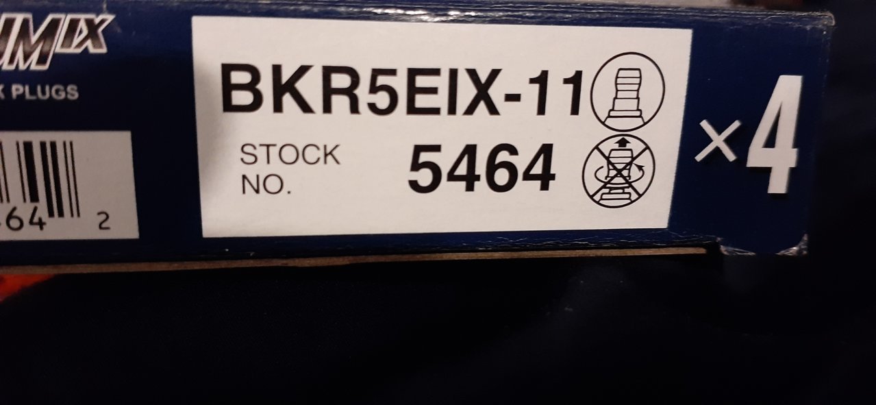

    NGK 5464 plugs.

    That is what I put in the truck.

    Right, 3967 is the correct ones. 5464 are incorrect.
