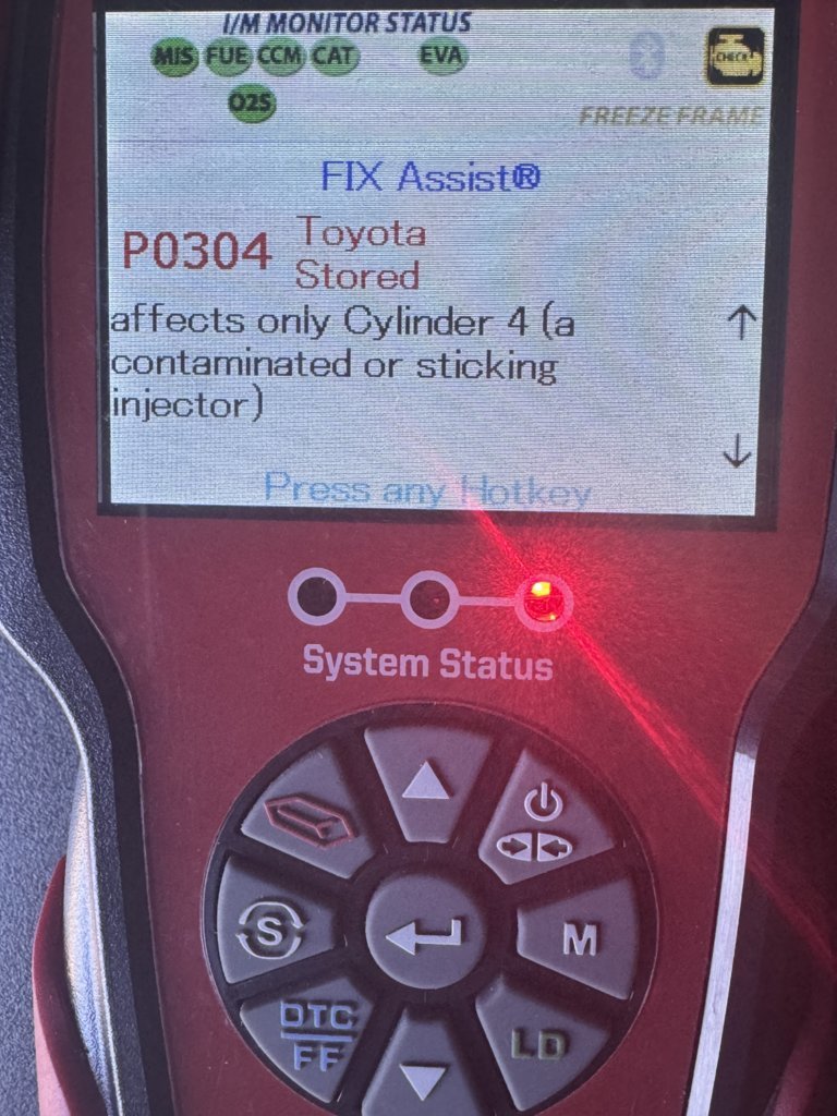

    Ok thanks this is the info I get from my scanner also say could be pcv, mechanical or ignition that’s why I was looking at fuel injector

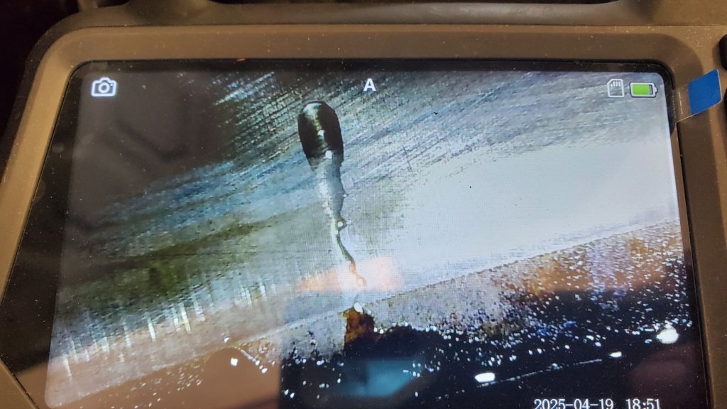

    This is what you will typically see with a headgasket leak, this one was pretty bad but gives an idea. Sometimes it takes quite awhile for a drop to form.
