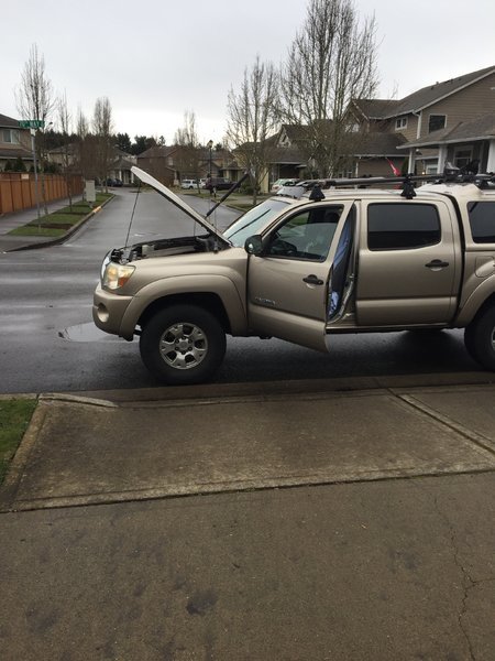

    2007 Tacoma, v6 giving me P0333 code: knock sensor 2 circuit, high input bank 2.
    From reading other threads in here with very limited info as to where in the bowels of the engine is this so called sensor....
    I am in need of info detailing where exactly it is as it is dark and raining at my location. Is there a site where I can instructions on how to proceed? I do not mind paying for it as the labor on this is > $2k.
    I am off to eat dinner.and return shortly. Some.pics to prove I am not bluffing

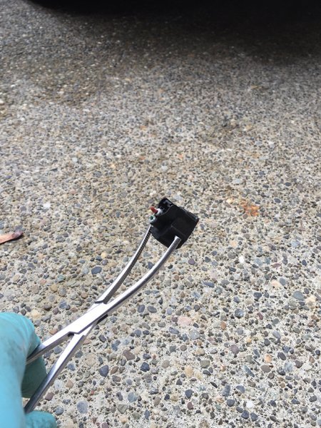

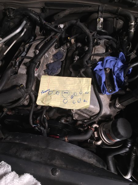

    FINALLY!!! image.jpgDisregard the white piece of towel. That damage was done by me as those clips are worst than pulling teeth
    UPDATE 19MAR20172012330
    You'll need these:
    82219-0C010 - wire sensor
    17176-0P010 - Air Surge Gasket
    You may reuse the old one if careful...
    17177-AD010 - Intake Manifold Gasket You may reuse the old one if careful...
    17178-AD010 - Intake Manifold Gasket You may reuse the old one if careful...
    16341-AD010 - Water out Gasket (two of these) You may reuse the old one if careful...
    96761-35031 - O-ring (two of these)
    00272-SLLC2 - Super Long Life Coolant Buy 3 gallons. You can always take the unopened one back

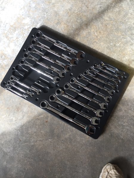

    Tool kit above is 50% off. 60 greenbacks plus tax.

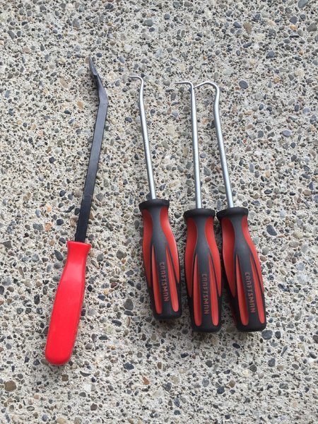

    Some of the tools that I had to go buy (needed HD pick tools)
    I guess I am 50% done with this and also fighting a big headache. Keep forgetting to drink water as I am too focused on the teardown.

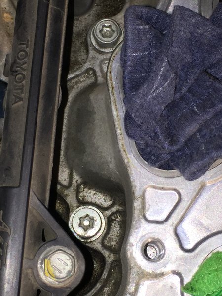

    That security torx bolt, don't worry about it. That only splits the lower plenum halves. See the bolt above it? 12mm. Just untighten those to remove the lower plenum from the heads. Then you'll have greater access.

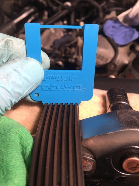

    Fan belt just finished. I am taking my time and double or triple checking my steps. Those clips sure where a a madafraker to get on on the sensors. Had to loosen those sensors and finagle make and female until they click
    Just a teaser so you guys know I am working and not bs'ing around
    Bad/worn out belt with 84,xxx miles since factory installed
    Look closely and you will see gaps in the grooves

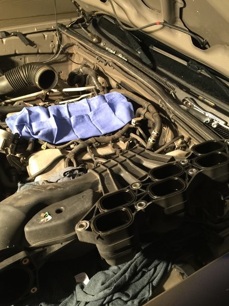

    image.jpg Any one knows of the bolt of sequence for the intake manifold to the heads????
    I need info asap as I am stuck at this stage. Also need torque specs please.

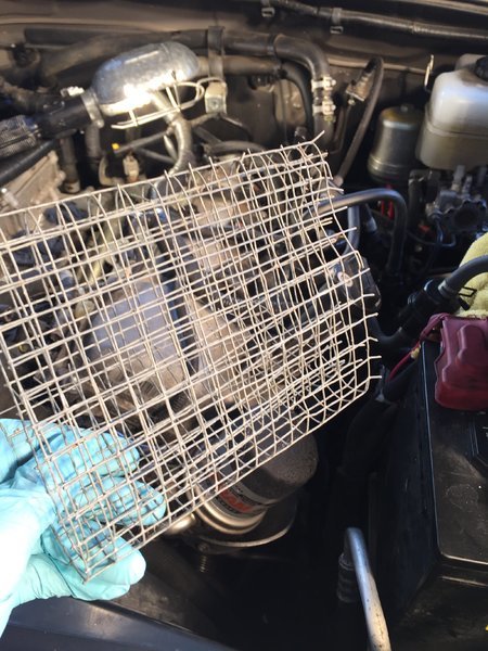

    Would it be overkill if I put this in the valley in order to give those wire chewing little turds a harder time to get to my wires??? Lol! I think I lost it!

    Good idea on the wire "fence" but they will be able to get through it with no effort, plus there are other wires to chew. Perhaps one of those under-the-hood rodent repellents would do a better job and protect the entire engine bay
