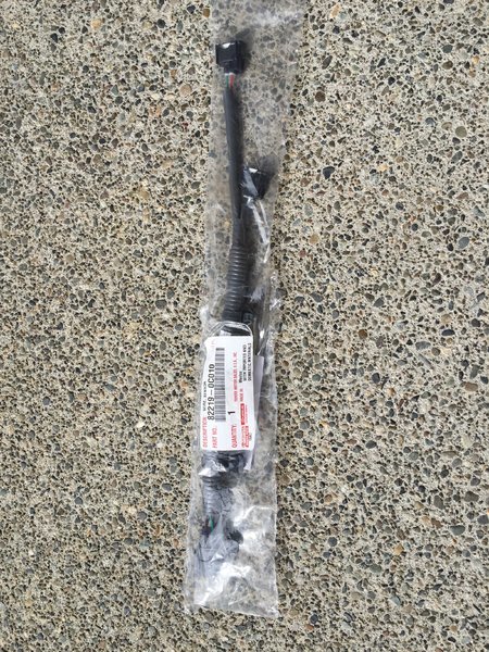

    Sorry, bro. My tittle or somewhere in this thread misled you to believe that I did replace the KS. I did not. What I replaced was the harness. See pic on post 7. Do you have to replace the actual sensor on yours?

    Finally got all the parts due to holiday and crazy COVID shipping, and finished install today. Started up and... now it's throwing p0328 and p0333 so I've gained one TC! I've been clearing the codes with my ultragauge but they keep coming back. Anyone have any ideas? For whatever reason, I couldn't remove the two pipes above the harness and had to snake it in so maybe it's not seated well enough.
    Edit: I have a dumbass theory now, as it appears the end that was chewed off of mine is black and white wired while OP has red and green. Not sure if that's switched for some dumbass reason on a Prerunner but I'm gonna go tear it all down again and try my dumbass theory. Will report back for future people.
    Edit 2: Yep, dumbass theory worked. So apparently 82219-0C010 - wire sensor is not the right part for a v6 Prerunner, even though the eBay listing I bought it through said it was a match. Not sure what the correct part number is as I just spliced my chewed up harness with a connector from the new harness.

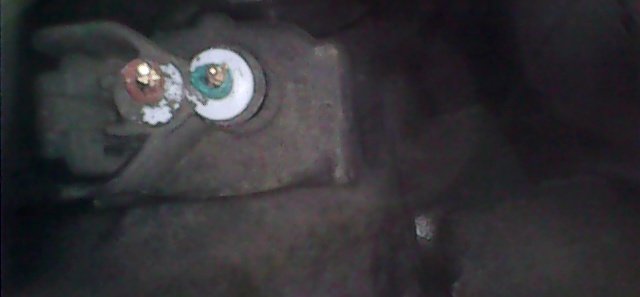

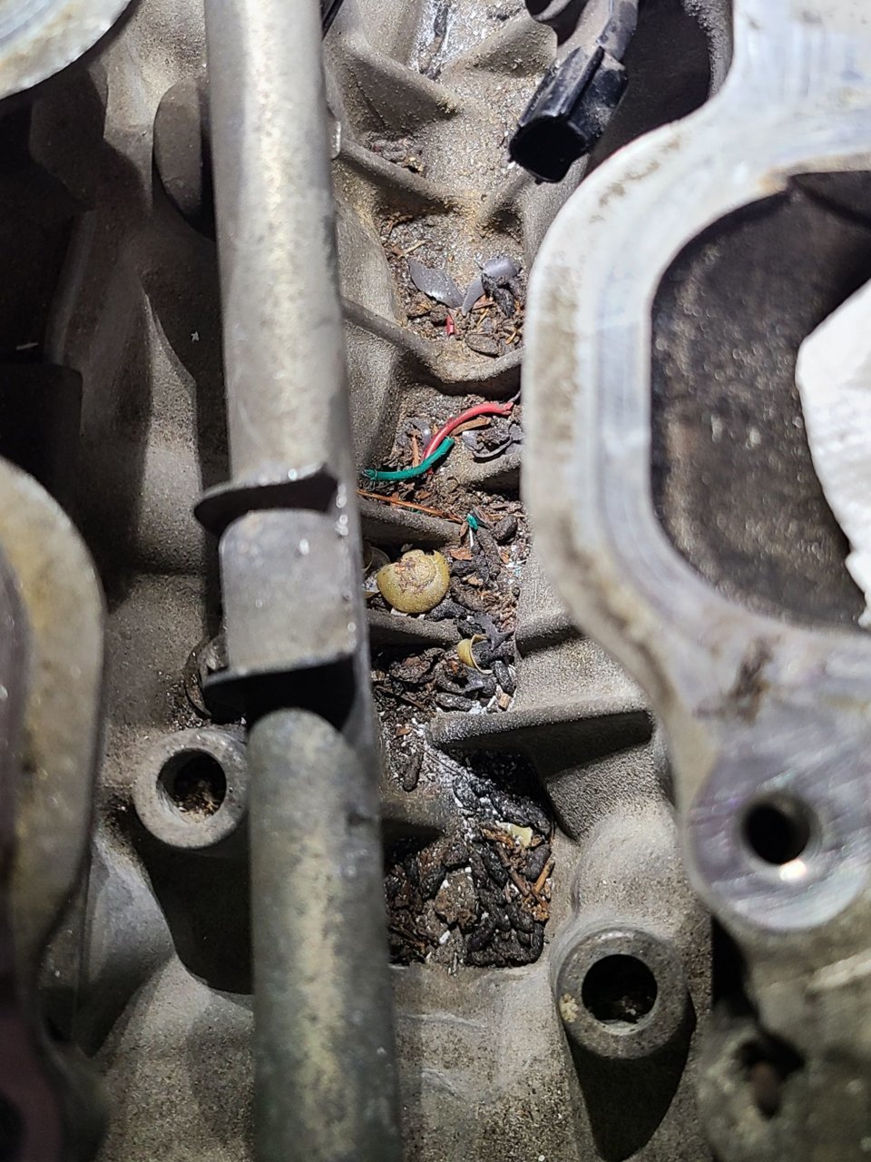

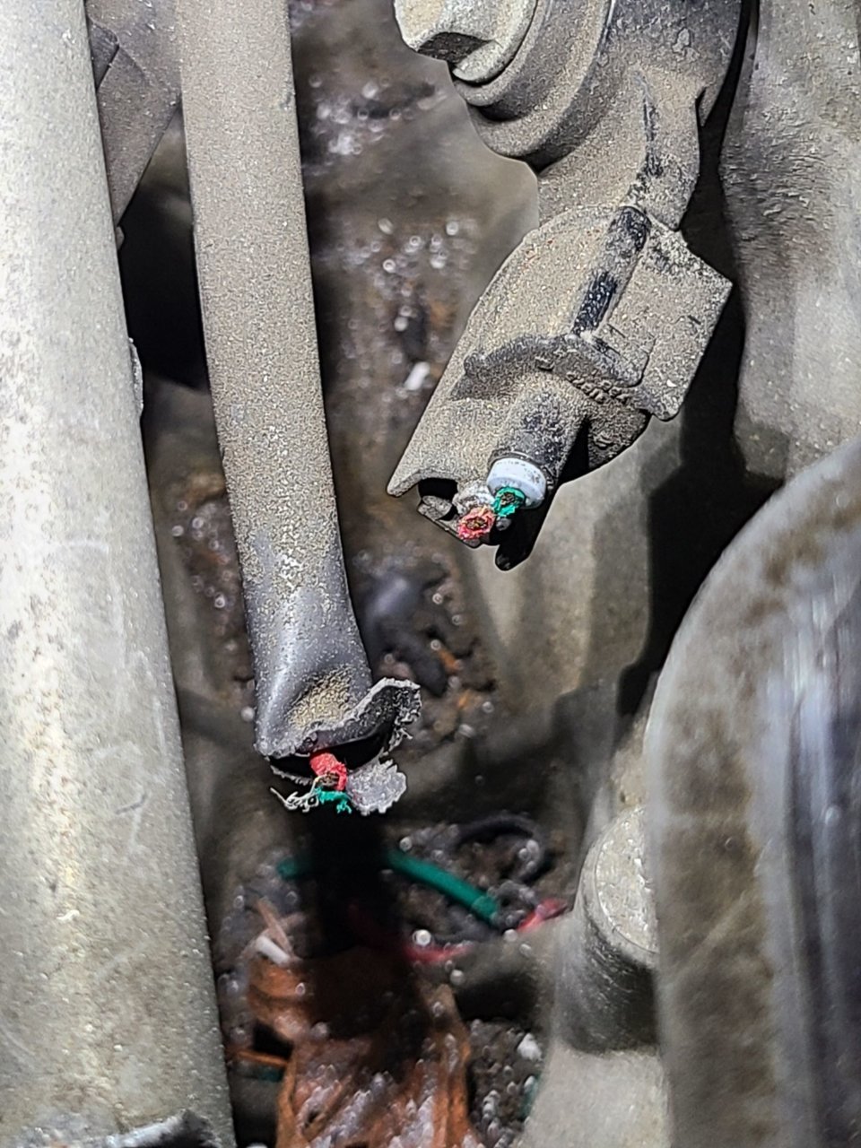

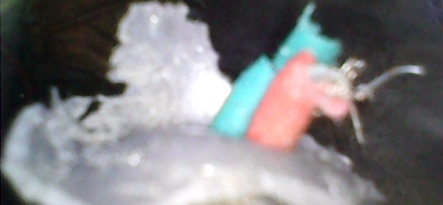

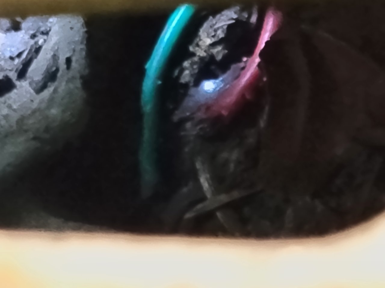

    Same thing just happened to me, got home one night from work, truck was fine, the next morning P0333 code. This is what we saw with the endoscope camera, and after we tore it down...new knock sensor harness installed along with a shit load of Cayenne Pepper!!aataco3.jpg aataco1.jpg aataco5.jpg aataco6.jpg

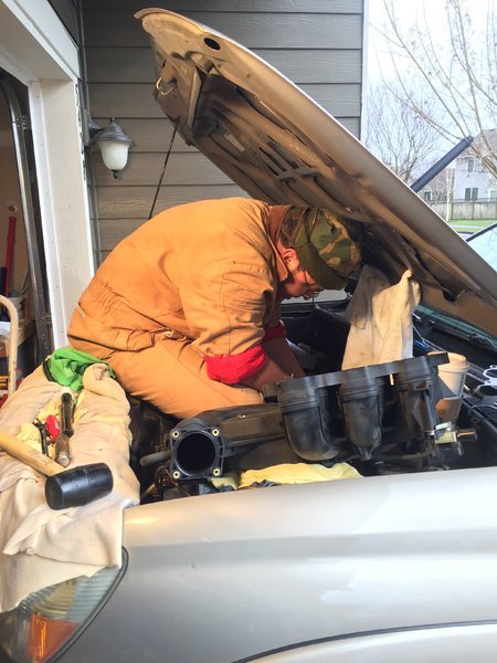

    Great picture! At 61 yrs old, I’d need a crane to pull me out of that position! :eek:
