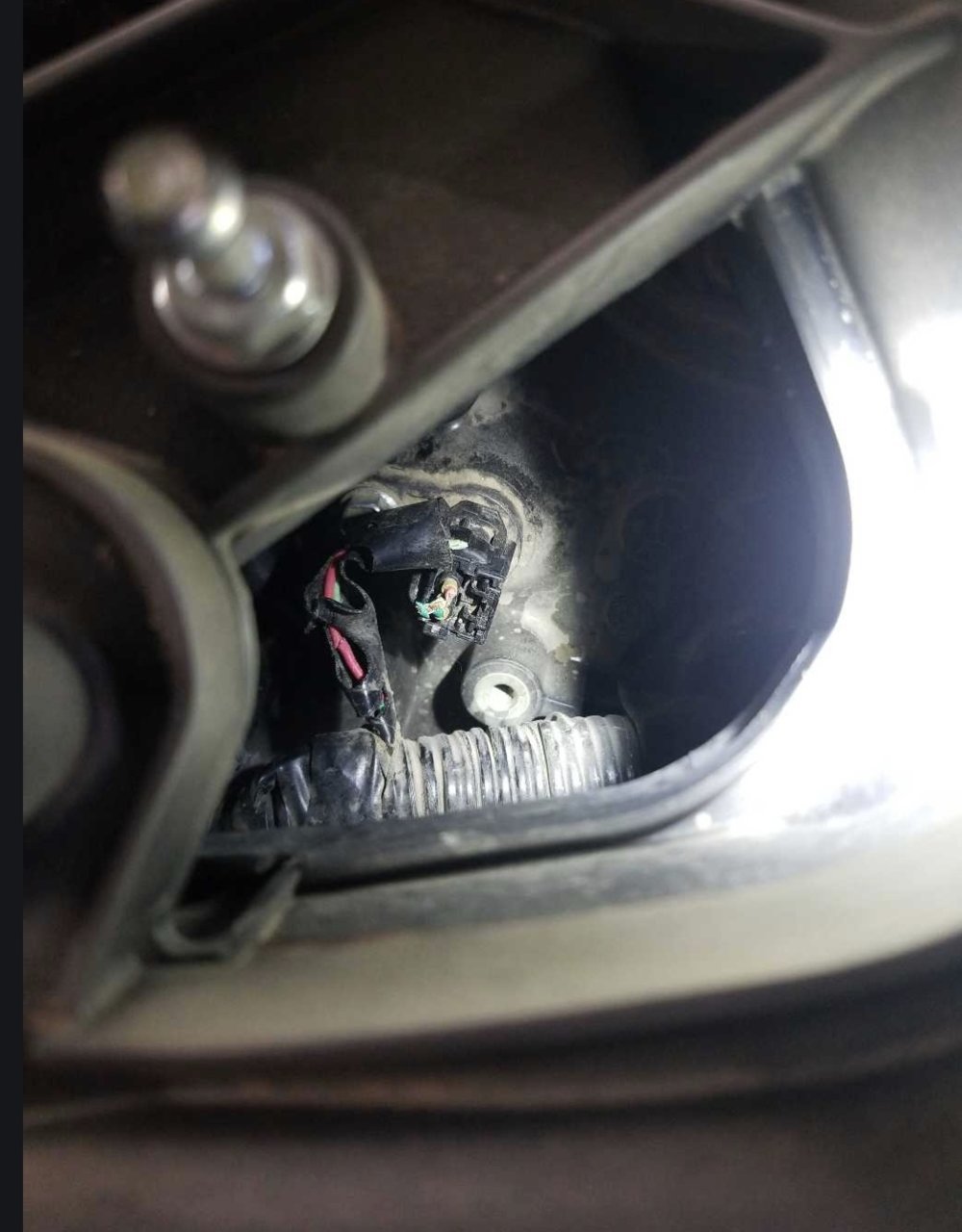

    So my engine light came on and took it to my nearest dealership. The code was for camshaft position sensor. Apparently rodents ate up my wires and estimated fix is $1400 for labor and harness. Anyone ran Into a similar situation and have a cheaper fix?

    It's pretty obvious what the alternative is to pulling out the entire harness.

    It's happened to others on here, no need for a full harness replacement. Toyota sells replacement connectors and pins, sometimes even the whole connector already pinned with a few inches of wire to just splice in with.
    Edit: I leave my plastic cover off as that area under the intake manifold seems popular for rodents.

    These dealerships get absolutely no sympathy from me. This is a matter splicing in a pigtail or, worse case, you have to pull the harness and then install the pigtail. Why would they need to replace the entire harness? In another post, a guy was sent on his way after an oil change that resulted in lost oil pressure due to the "techs" screw up. The dealerships remedy. Put oil back in and send the guy on his way.
    If a tech had broke the housing on that connector, you think he would have pulled the harness? Hell no. He'd have spliced a new one in and probably told no one. I'm not sure I'd even have a problem with that.

    LOL what $1400? Just get a donor pigtail and splice it back on the harness. $10-20 tops

    Exactly....tell the "tech" to go out back and pull from a donor. Pulling the entire engine harness is going to possibly create more problems.

    Repair is easy. If you’ve got full coverage insurance typically just replaces the whole harness. But yea. Repair is easy once the plenum is off
    that being said I’ve done 6-7 of these for damage in the same spot, when they opt to go through insurance they throw whole harnesses in it.

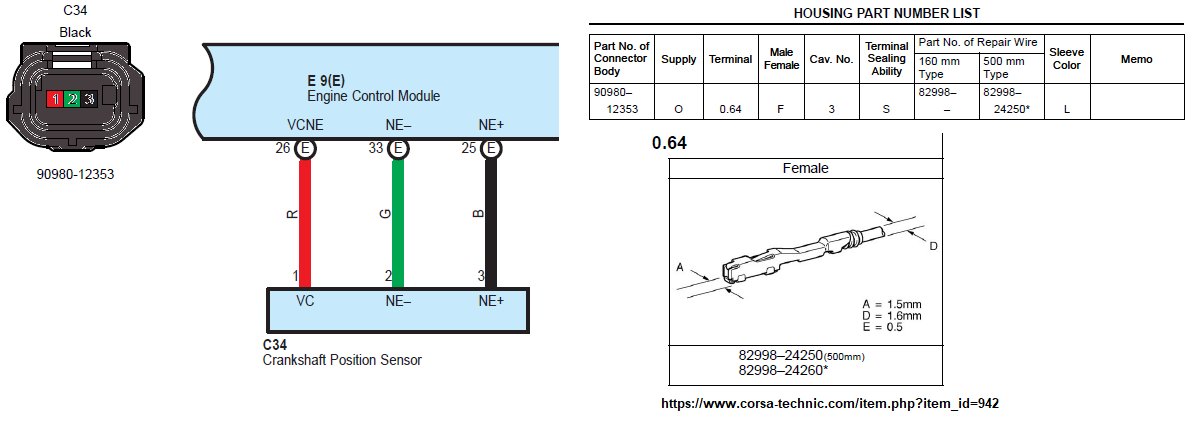

    Can someone inform me of where I can locate this picture (minus the chewing) on my vehicle.

    go to the dealer and ask for the pigtail of that connector and splice it in by yourself. pigtail will probably be less than 30$

    $2.66 plus shipping on the parts for the pigtail...
