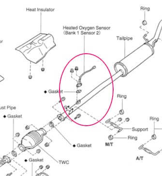

    Is this it?
    It's a 4, got 114,821 miles on it. This is the first time I got that "Check Engine Light" on. I was trying to see If I can fix it myself. I don't wanna take it to the stealer. Hopefully you guys and gals can help a brother out.

    That would be Sensor 2. Sensor one will be before the CAT. The code doesn't specify exactly which sensor may be bad. It just says the the two sensors are reporting very similar readings back to the ECU. Sensor 1 should be reporting a waveform while Sensor 2 is generally flatter.

    I had the same code last week. and it was infact the AFR sensor. Sensor 1
    I took it out and it was sooper black and filthy. changed it out from one from RockAuto.com and it is running better and no more CEL,:)
