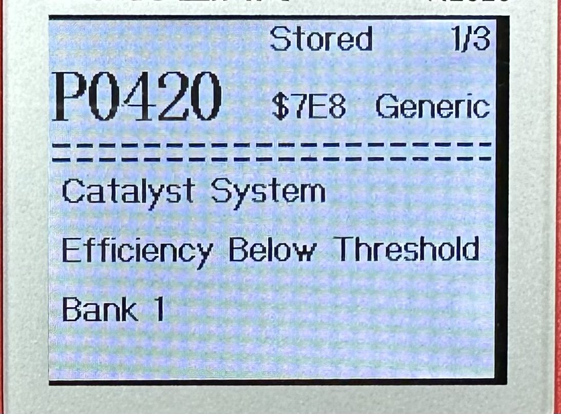

    Hello all,
    Truck is throwing this code once in a while. If this is the catalytic converter, would it be covered under the 8yr/80,000mi Federal Emissions Warranty?

    2020 Blacked-Out White DCLB TRD OffRoad 4x4
    One of your O2 sensors went bad. Usually lasts over 100k. Change all of them at the same time.
    Edit: my 03 Tundra gave that code for the sensor. It was the driver side upstream. Dont know why the taco would be different but….

    Oregon Coast
    2022 Tacoma access cab SR
    could be the cat or the O2 sensor or too much shoot/ grime from the engine.... I had a Subaru throw that same code and it wan't the o2 sensor or cat but the engine that was too dirty- sending out contaments that the o2 sensor was reading

    2015 TRD sport(sold) 2023 Tacoma
    PO420 is usually a bad cat.

    18 DCLB SPORT CEMENT
    Should be covered under the 8/80.

    2015 DCLB
    Yes it would be covered if it is indeed bad and the vehicle is under 8 yrs/80k miles

    7
    Note: About 1000 miles ago I had the direct injectors replaced on bank 1.
    Could this be a result from all of the fuel being dumped?

    2015 DCLB
    Converters don't like raw fuel. If one of the old injectors was leaking I could see it causing a problem

    for sure can.
