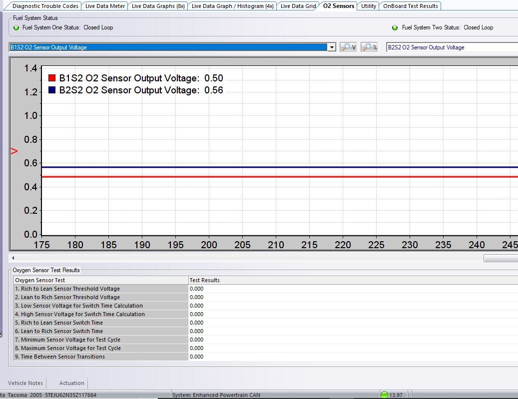

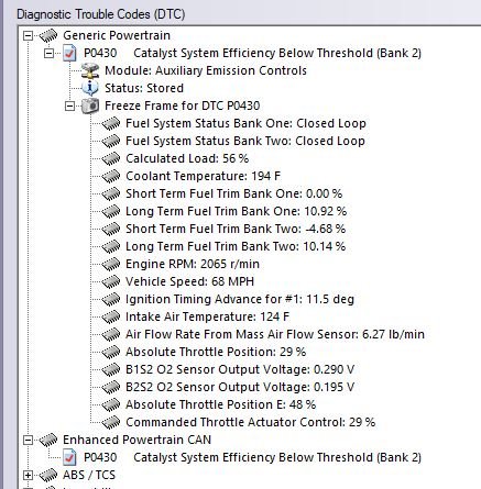

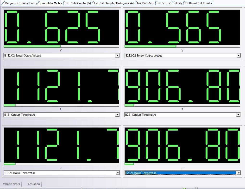

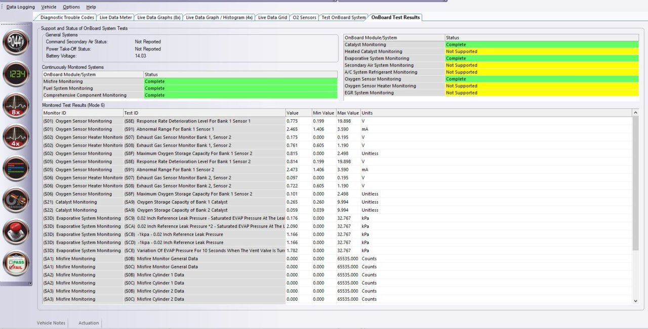

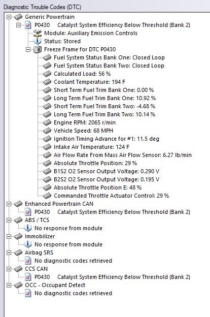

    I have a 2005 Tacoma with 4.0L V6. Approaching 200K miles, CEL comes on, goes off after awhile. P0430 Code. Attached are some screen shots from the scan tool. I am replacing the O2 sensors as they have never been replaced before. I'm keeping the truck, figured its good measure. Hoping someone here knows how to read the fuel trim data and give me some direction. Light is out right now. Before buying CATS, I'd rather PAY once and get it right, not shot gun it.
    Also, is bank two on the 4.0L V6 the driver's side?
    Thanks! Marty
