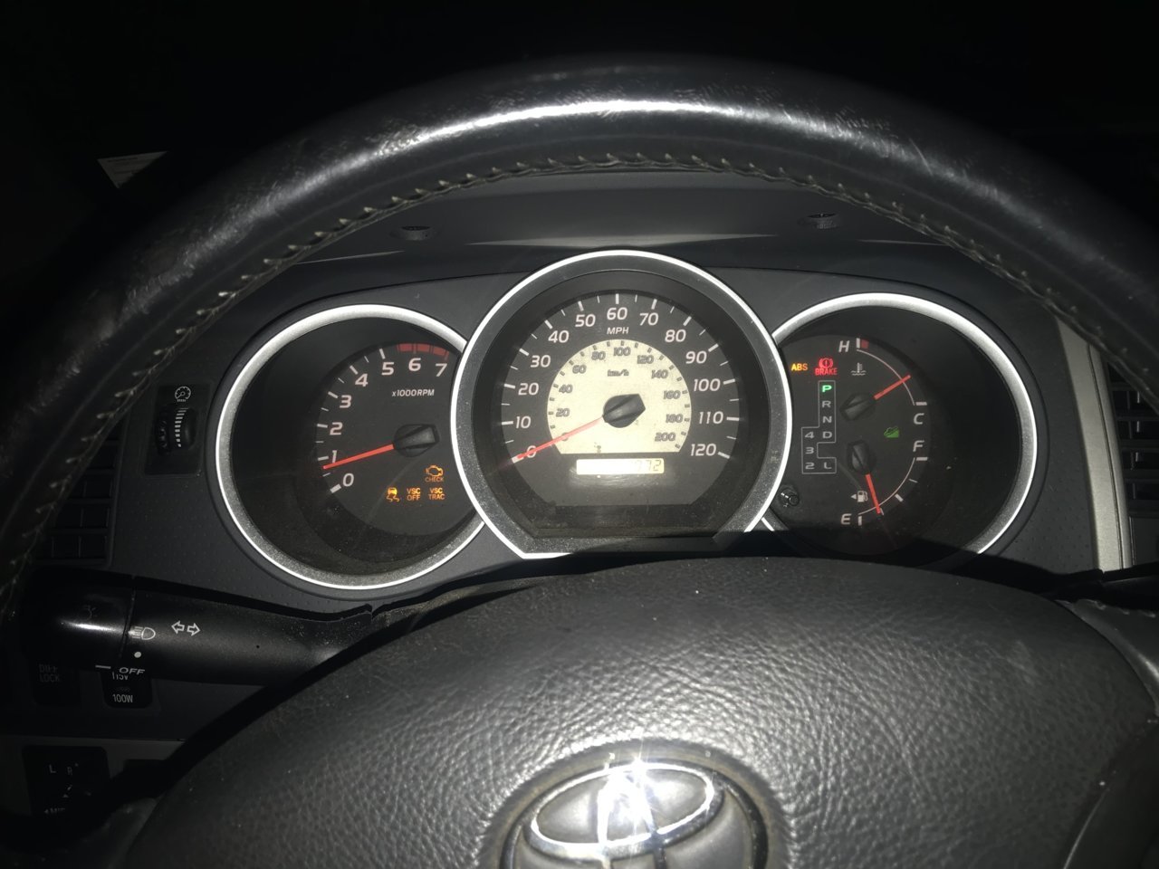

    I finally got the dreaded P0500 Code after 15 years of hard use of my 2005 TRD OR DC 4.0 L
    ABS and Brake lights are on.
    The strange thing is when I step on the brakes, the VSC Off, VSC TRAC, and and Downhill Assist lights up.
    When I release the brake, the lights come off except for the Brake and ABS lights.
    AC, blower, and power windows do not work.
    Radio works fine.
    I checked the charging system and the alternator was undercharging, so replaced it and the dead battery.
    The dash lights are still on.
    What next?
  20. Aug 17, 2020 at 9:06 AM
    #80
    TireFire
    TireFire Superunknown Member
    Feb 6, 2016
    #177349
    7,662
    Olympic Peninsula
    Get to checking fuses
    Jimmyh likes this.
