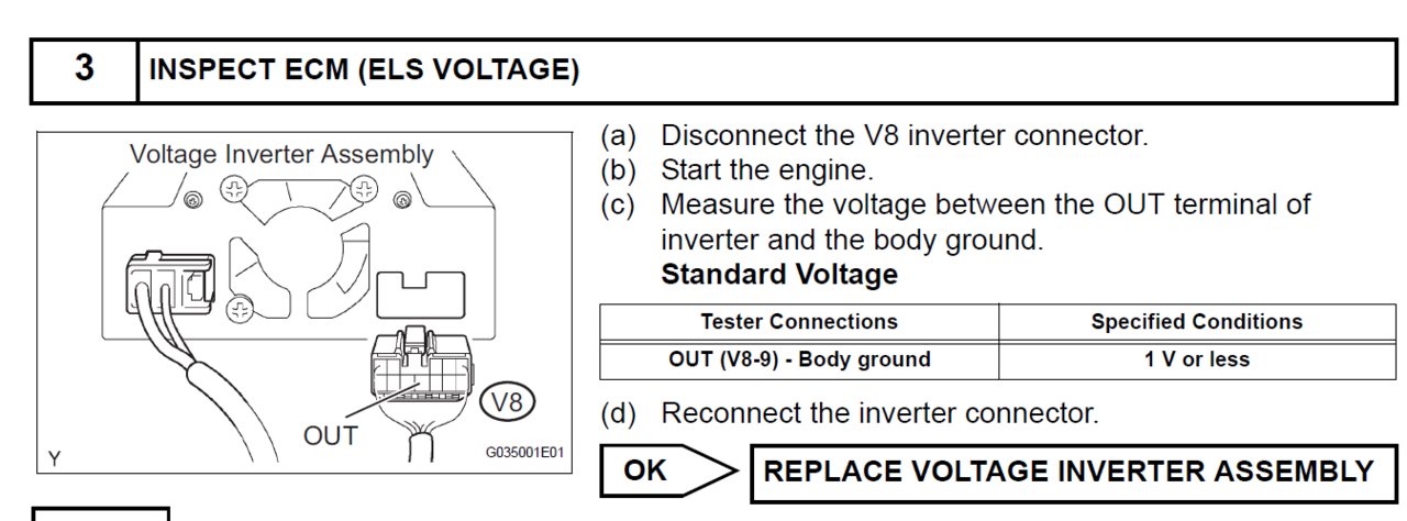

    Apparently it's due to an idle-up signal from the inverter, for over 10 seconds.
    This link is seems helpful:
    https://zinref.ru/avtomobili/Toyota/211_Toyota_FJCruiser_GSJ 10_15_series_2007_english_copia/082.htm

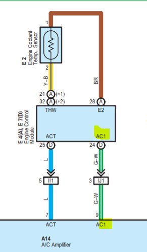

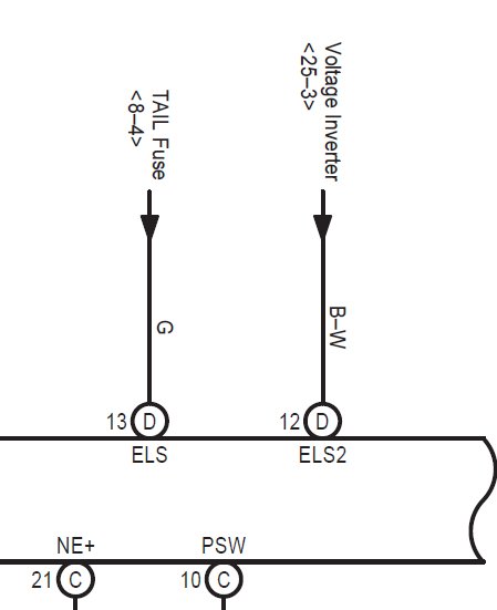

    I don't want to relocate and rewire a new inverter so I'm fine removing the idle-up signal.
    I have the wiring diagram attached. Do I just cut the black and white wire?
    Does the idle up signal send voltage to the ECM?
    Will there be an issue with either the ECM or inverter with an open circuit?

    Disconnect the Black wire with white stripe from V8 terminal 9. Cap the end coming out of inverter to prevent any shorts.
    There is also an electric load signal to idle up sent by the tail light fuse, so your truck will still "idle up" if you leave the parking lights on the same as if the inverter was running as well as while the A/C is on.

    Update on this fix. Disconnected the idle-up signal. Cleared the code and it didn't come back.
    Drove around all weekend using the inverter. It was mostly working except the inverter would turn off when idling.
    This includes when I'm in drive and stopped at a stoplight or traffic.
    Pretty annoying but I just kept turning it back on and it was working fine.
    This is probably the best I'm going to get with this mod but anyone have some crafty ideas?

    it may be looking for a sensed load from the PCM when it outputs the idle up voltage. You could put a CLR in there and allow the idle up output to have a load on the terminal. I’ve never seen a detailed schematic for how the inverter itself works inside for the speed and idle up logic so this is just a best guess it might fix your issue.
