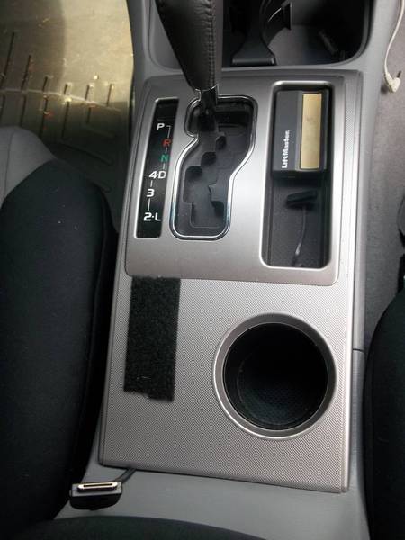

    Belt holster attached to a bracket I made out of aluminum strip metal from home depot. I put velcro on the bracket and on the shifter bezel. The velcro actually works/holds the bracket better then you would expect. Ignore those lines/marks on the backside, those were on there from another project that I never ended up finishing, I just used this piece of aluminum from that unfinished project.
    Velcro on shifter bezel and the PA15-TOY cable ran under the bezel
    Bracket mounted with velcro
    Bracket with no phone in it

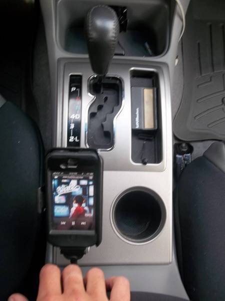

    Bracket with phone.
    It is perfectly positioned and angled so that when in "Direct mode"/Disc 8 mode, I can control it while my arm rests on the arm rest

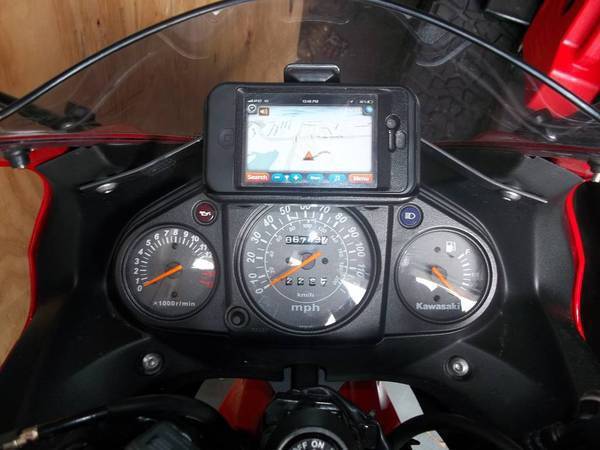

    This is the bracket I made for my Kawasaki Ninja 250 that gave me the idea for the truck

    Heres the link to it.
    http://www.ninjette.org/forums/showthread.php?t=68101
    Since that post I have painted the bracket and re-bent the bracket to a more appropriate angle that doesn't block the gauges as much
