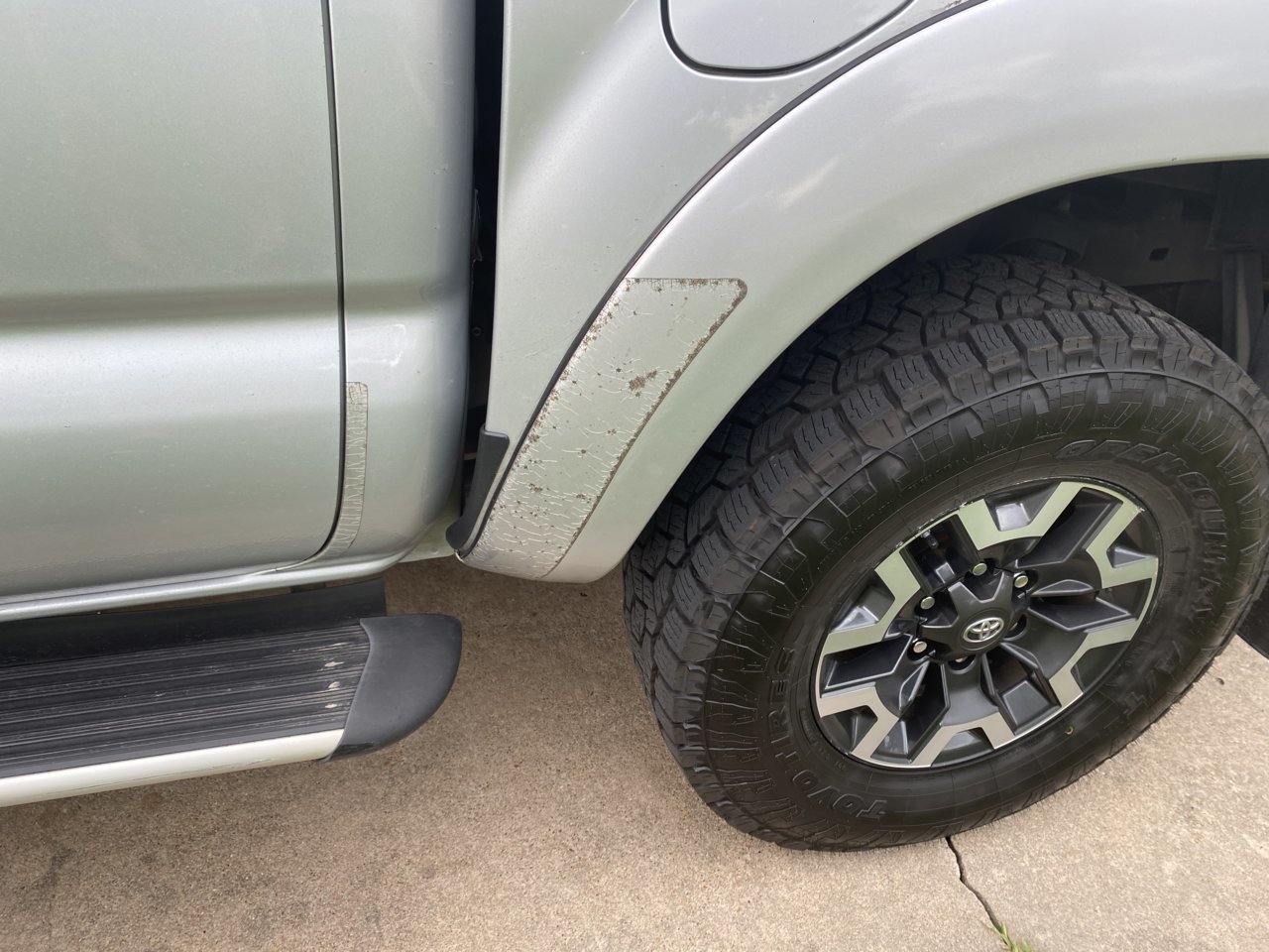

    Anyone have a solution for the problem with the plastic- paint

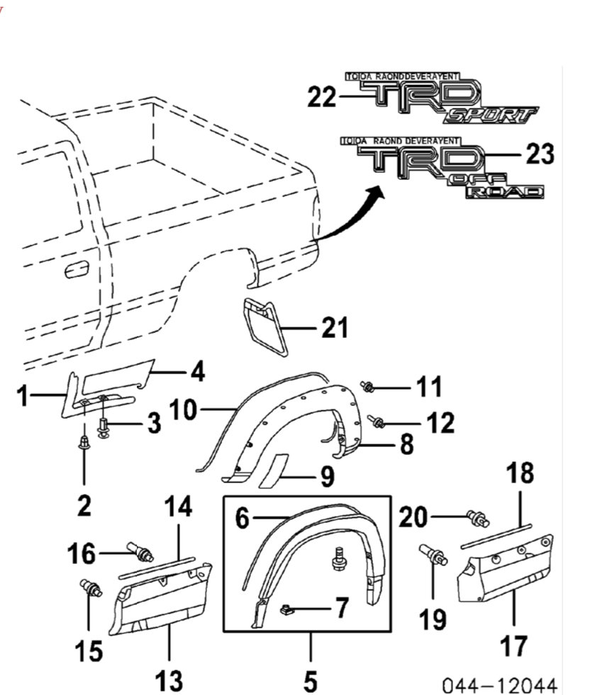

    It’s not paint.
    It’s a plastic sticker.
    You can peel it off and replace it.
    I’ve heard it a real PITA to get off.

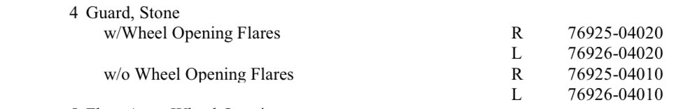

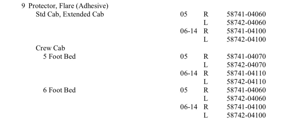

    The parts are #4 and #9 of the illustration.C8C27B11-32CB-4A02-B2E1-EF7421FE3806.jpg

    from that info pic , type that long # next your truck model in google .39$ on ebay
