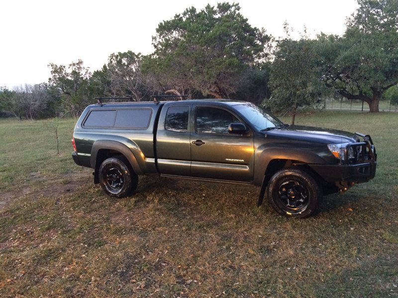

    to get the best results, id sand down to bare metal, lay down a couple coats of primer, and then a couple coats of base coat, followed by clear coat if youre doing a two stage paint. Two stage is typically only used when color matching it.
    I got paint from automotivetouchupstore.com to color match my shell and bumpers.
    Heres how it turned out, the shell was white when i got it off craigslist.
    If you dont plan on color matching, id still use a couple coats of primer but then id probably just go with rustoleum and lay down 2-3 coats of that. You can do more than that to make it more durable, but that should hold up pretty well.
