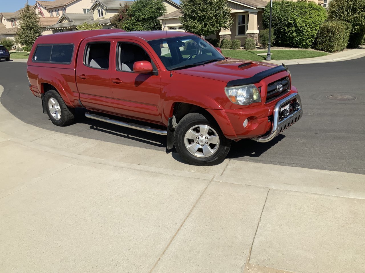

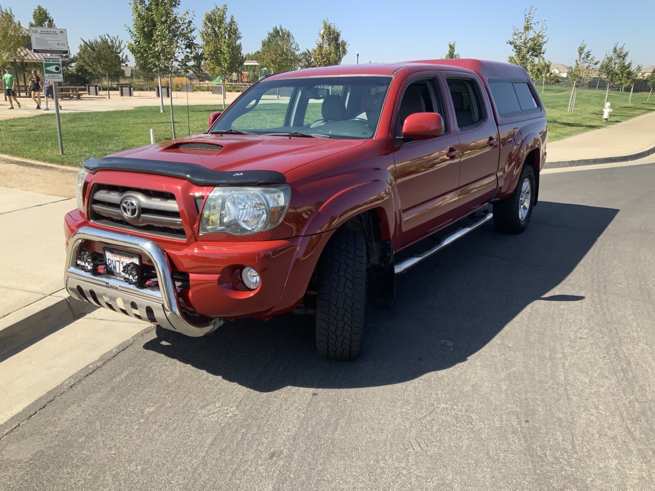

    3A9103BE-1CAA-4917-B59E-4AA2E6E7A1E1.jpg F112C8B0-1D31-4D7C-8047-B8DA2E43E29D.jpg Go for 2 stage paint job not one stage. One stage won’t last and will never look great. Almost a year ago I got my truck and camper shell painted , 2 stage paint at Maaco for $2500, that included everything. It has a 5 year warranty and looks damn good. Try a different Maaco and see what they offer. It’s just not worth $6000 or more just to paint a 13 year old truck. Here are 2 pics of my new paint, they did a great job, no flaws.

    Looks good. But appears they painted over the rubber mouldings between the fender flares and body. Correct if I’m wrong. But if they did they would be a flaw in my book. But then again it is a $2200 paint job. I’d put a 6k paint job on a 13 yr Tacoma knowing it probably has another 13 yrs in it. But that’s me.

    Every time I look at the pics of this truck and its MAACO paint job, two things come to mind.
    1) From 10-15 feet away, it looks pretty darn good.
    2) Up close though, you'll find all of the usual signs of a cheap paint job. As has already been mentioned, they didn't mask the fender flares properly. But that's just a symptom of poor masking everywhere else. MAACO (and all other quickie spray places) mask things instead of removing them. What this means is that around headlights, taillights, emblems, grills, textured black trim (like on the bed rails), and around bumpers (just to name a few), there will be ample evidence that the vehicle has been painted - and not very well. No thank you.
