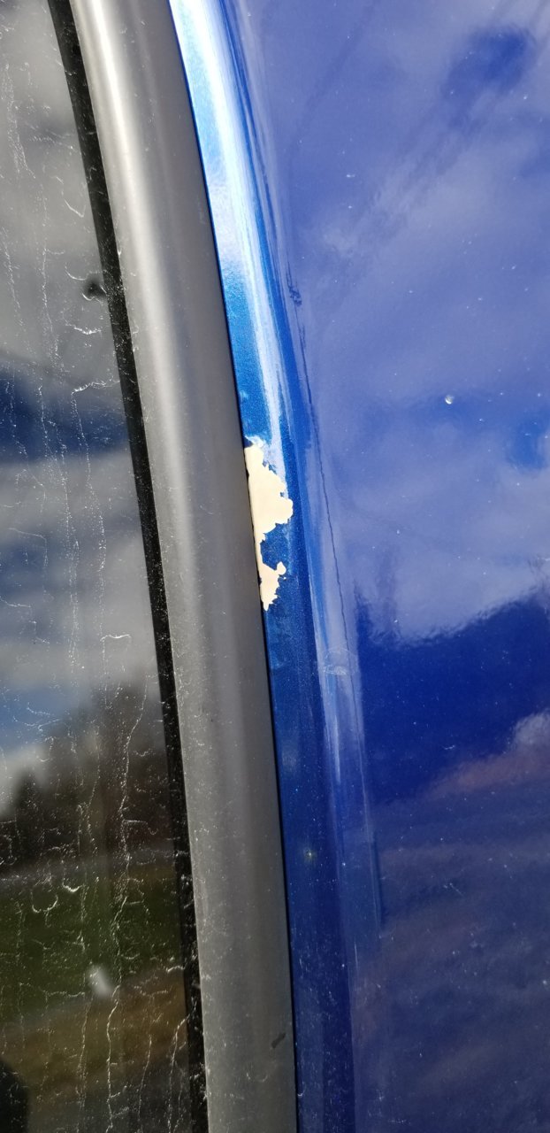

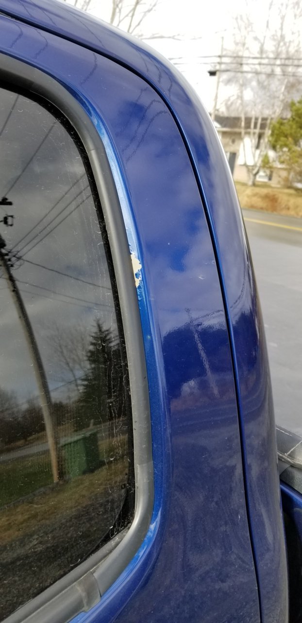

    Yup, here you go...

    Mine is like the second picture but further up the door

    Is yours the same colour ?

    No mine is Super White and 8yrs older than yours, bought it new and have always hand washed it
    This really pisses me off about Toyotas quality or lack there of for all these years

    Yes, I've always hand washed as well. Also waxed 3-4 times a year with good quality wax. Seems like all that work was a waste of time.

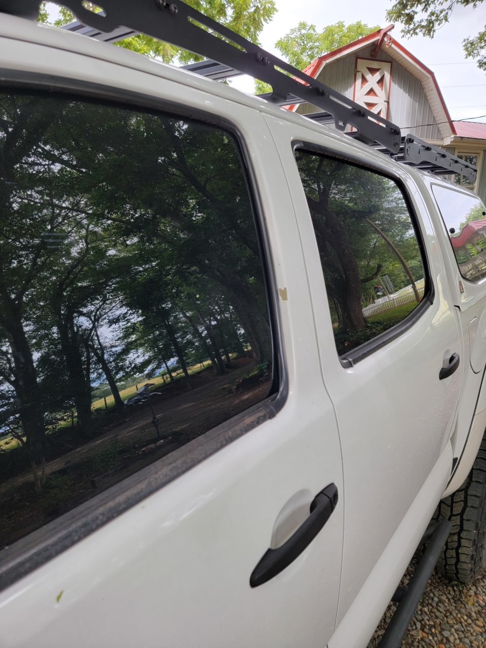

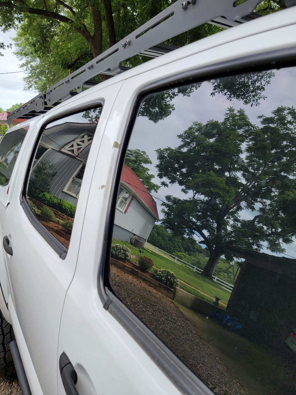

    Old thread is old, I know - but having the same issue with my super white Tacoma. Went to the dealer collision center and they won't consider it apart of the recall even though it's the same f'ing paint as other Toyota's.. called Toyota Corp. and spoke to every department I could while explaining my case and the issue of Tacomas not being apart of the issue. They said if more people called to complain then they might do something about it, but until then it's my responsibility.
    It's getting worst each week and I really don't want to drop $1k at a detailer but idk what else to do..
