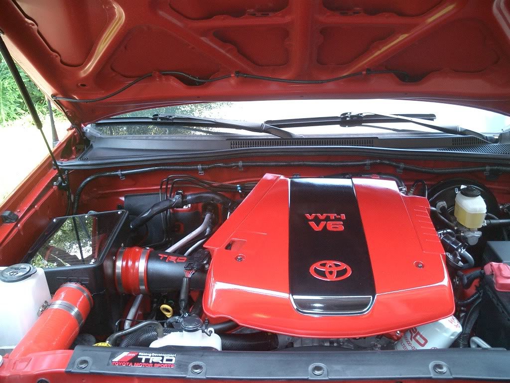

    I like the look! Good job on that.

    Looks good, remove your badges and have him letter them in to match.

    looks great! I have never seen anybody do any pinstripes on their taco's engine cover. Your buddies did a great job!

    :thumbsup:....Very nice!

    Yeah, that's nicely done! I want mine done in Red to match the TRD CAI rubber joints.

    It looks good. I did the same thing.
    BSP for the insert.

    That looks sharp! What kind of paint did you use and how did you prepare the plastic cover? I like the clear air box lid, very cool!
    Tell me about the front air intake pipe you have running to your CAI box, custom modification? Does it make a difference?

    Best I have seen so far! Awesome!

    LMAO yea right.... Like it would match your red truck. Nice try though.

    Now that is sweet. Nice work under the hood. I notice you have the shock type hood "holder uppers". I like that!
    Guess I better get back to work to keep up with you guys.

    I like the clear air box lid, very cool! X2. Tell us about it. Details. Thanks

    bad ass!

    For the paint, I used stock colors, Radiant Red & Black Sand Pearl. I used spray cans. I sanded the pebble finish of the cover. I primed this and wet sanded until smooth. I then shot the red, wet sanded again. I masked off for the black. I shot the black, wet sanded again and finally shot the clear.
    I did all of these with spray cans.
    The plexiglass cover I made from 1/8" thick plexiglass. I have had a lot of requests to duplicate this for other people. I am working on getting some of these laser cut.
    The extra snorkel on the CAI goes to the grille and lets cold air come in from the grille. I see intake temps at ambient temperature or +1 degree.
