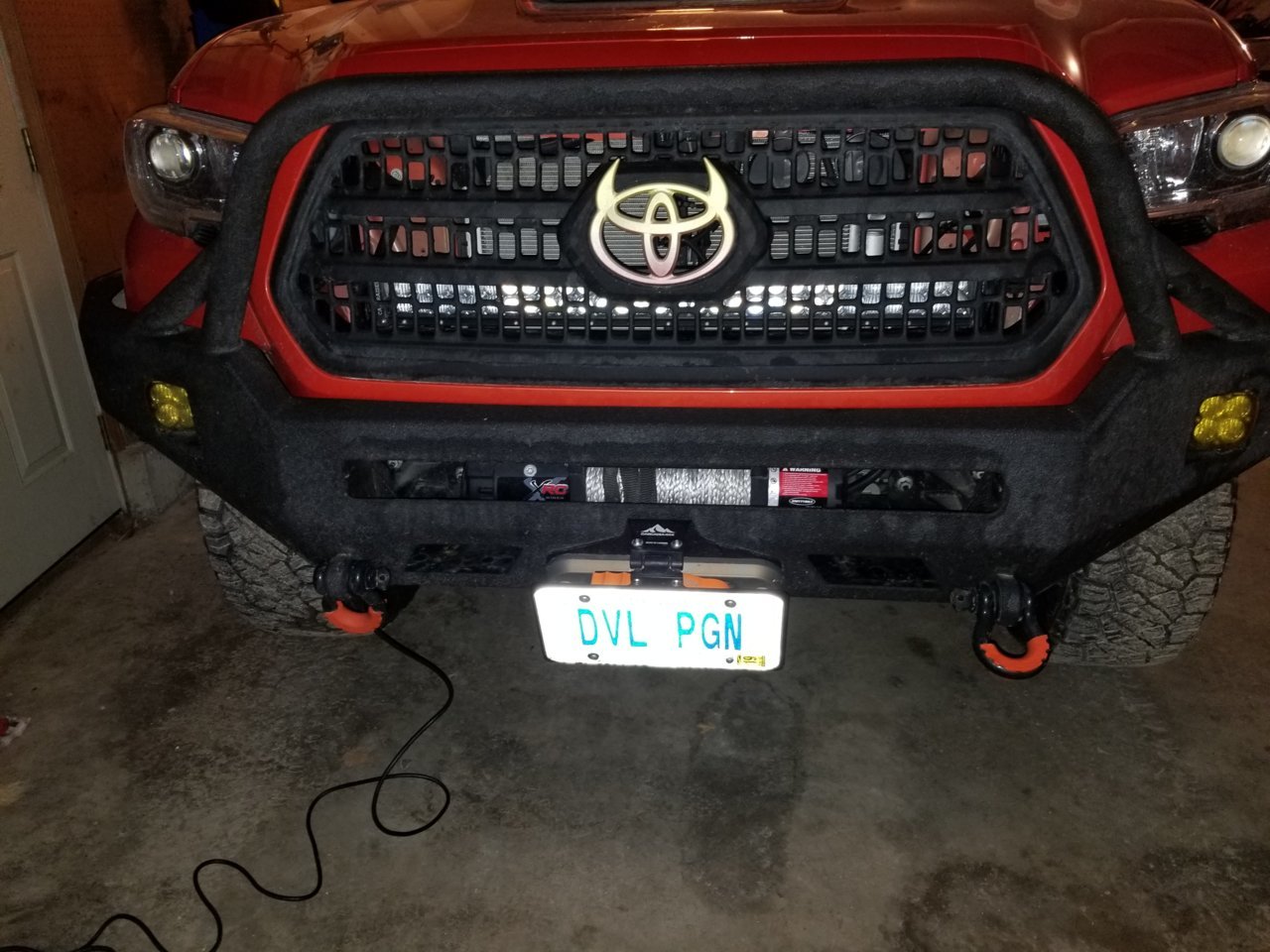

    I used a plastic primer after I scuffed to the best I could. Then rattle can bedliner. Been a couple years and still looks pretty damn good.

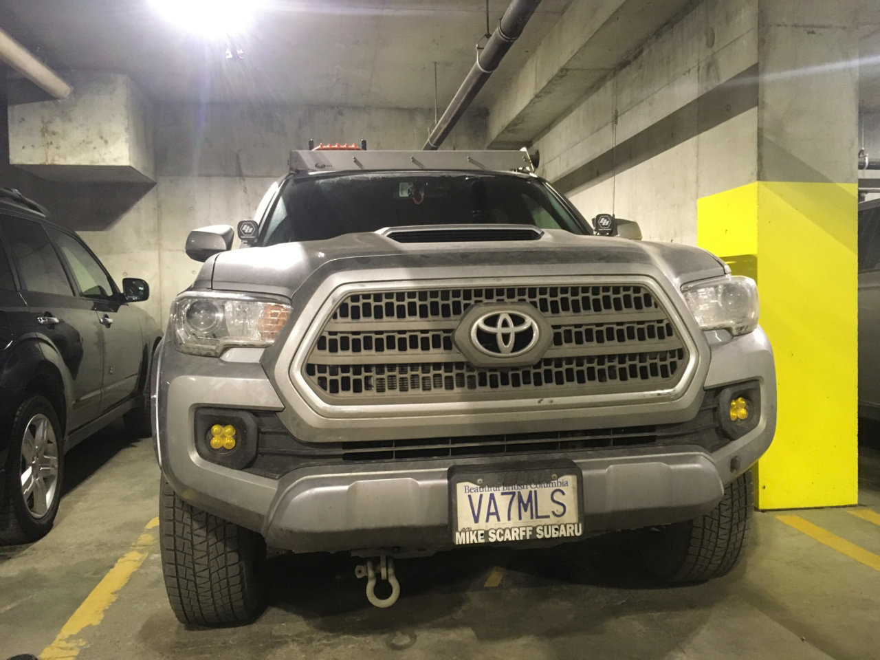

    I've painted mine with VHT Cast Iron, it makes a tough matte textured finish;
    Dirty winter pic but two years later it is holding up well;

    Did you use any primer or scuff it up prior to painting?

    clean it, scuff it a bit, clean it again, dry it, paint it.
    I've used this paint on wheels over primer and it works nice, keep the cans shaken and don't spray them right to the end of the can..
