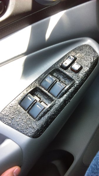

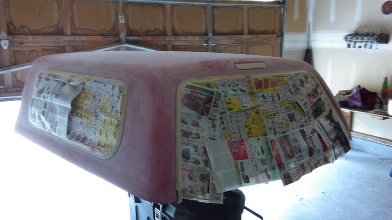

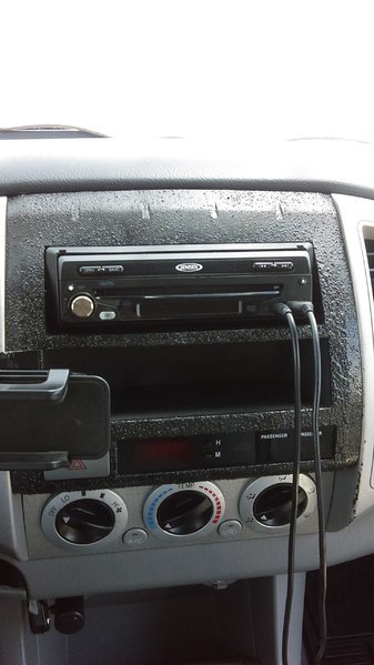

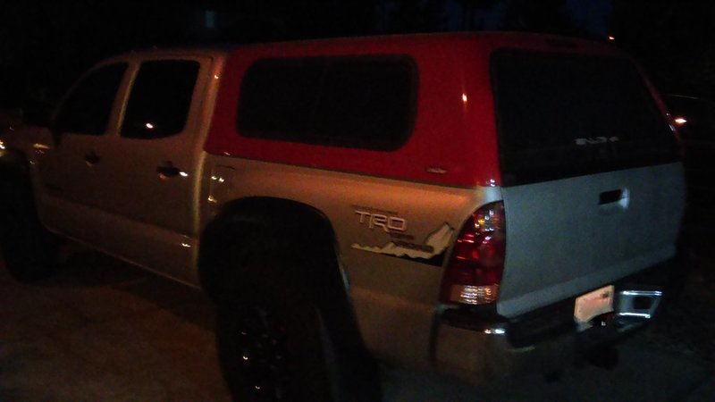

    Scuff it and bed line it I used the herculiner kit $100 bucks here's how my cap turned outIMAG0201.jpg IMAG0203.jpg IMAG0204.jpg IMAG0205.jpg 2016-03-28 08.51.09.jpg

    Interesting choice. Not sure I would have went with black on a Silver Taco. Don't get me wrong, it looks like you did a good job. The color combo isn't bad. Black usually works with most everything ...
    I don't know ... It's just ... I don't know ...
    Got it. The black fenders are throwing me off. Have you considered running a black stripe along the bottom of the truck?
