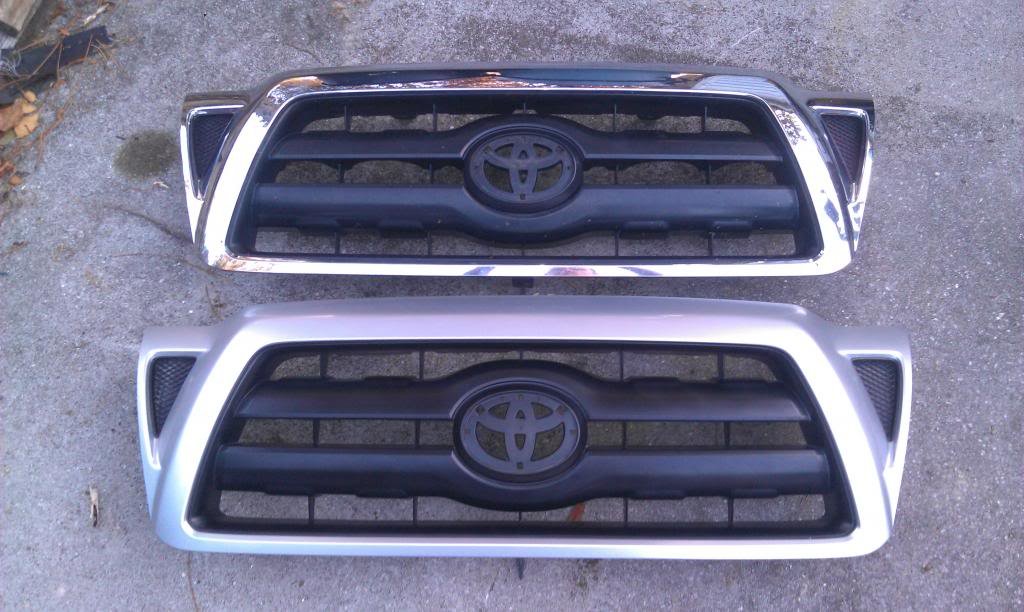

    What I did

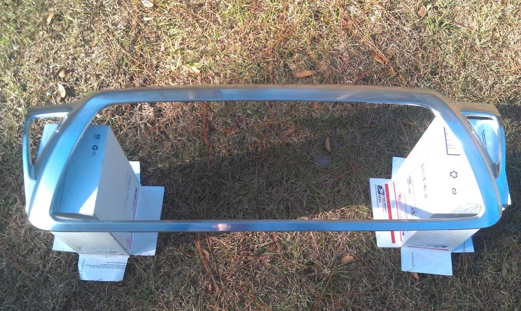

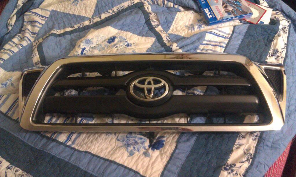

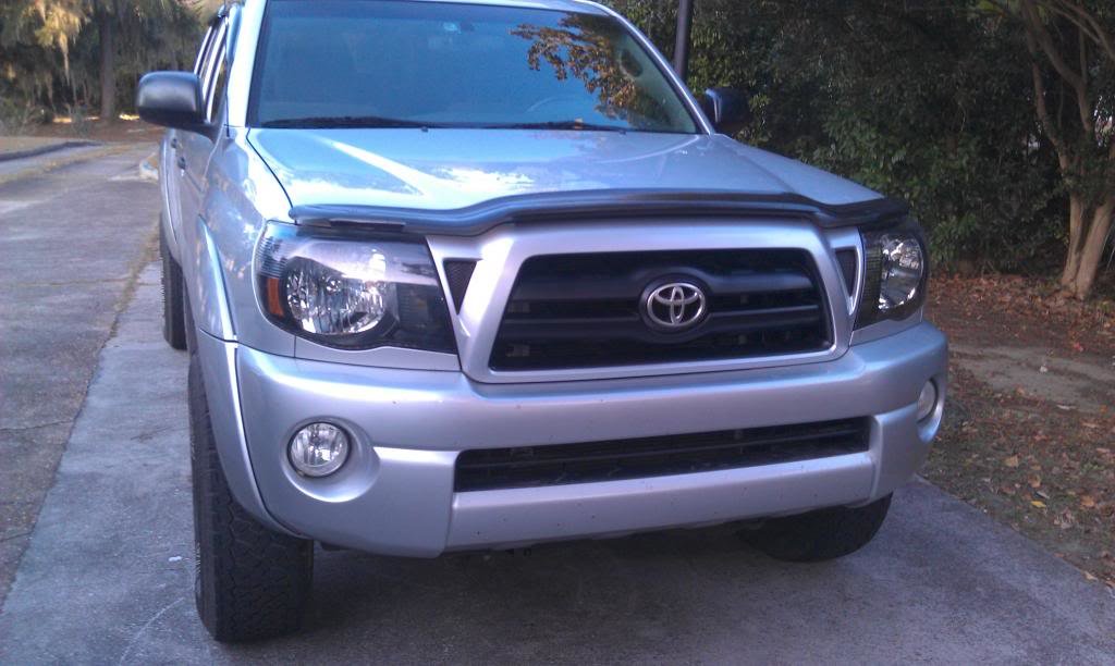

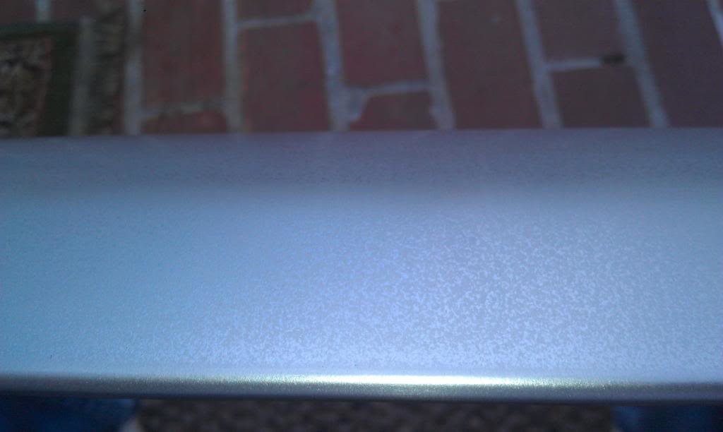

    Acquire 2nd grille in case I screw up:
    Removed chrome trim and scuffed with a red scotchbright pad until it looked like brushed aluminum:
    Laid on 2 coats of adhesion promoter, 3 coats of Silver Streak matched paint, and 3 coats of clear coat. Left me with this finish:

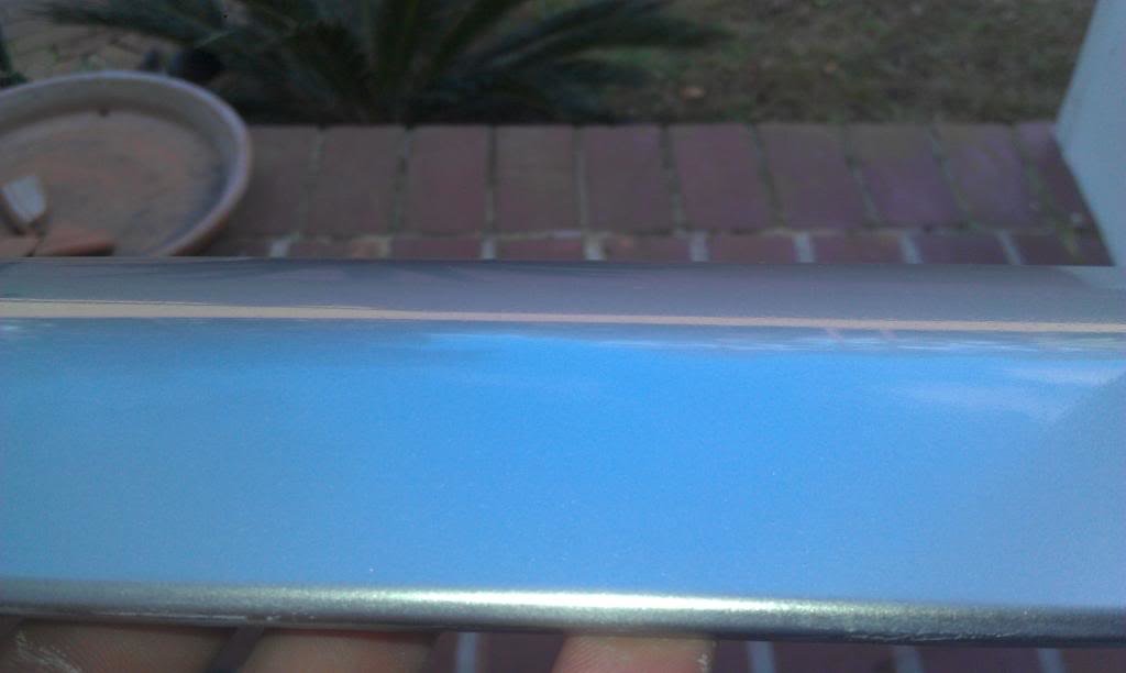

    Did a little wet sanding with 2000 grit; probably could have went a little further:

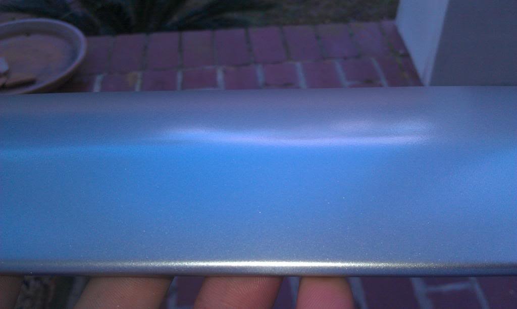

    Hand polished with polishing compound and a microfiber cloth:

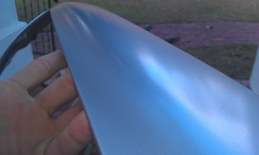

    Reattached the newly painted trim to the rest of the gill (the tricky part) and then compared it to the stock:
    And then enjoyed the new look :)

    What steps did you do to take it apart and reattach it. Did you grind down the clips or another way?
  16. Feb 1, 2013 at 8:48 PM
    #56
    iamsuperbleeder
    iamsuperbleeder Licensed Lunatic
    Nov 4, 2012
    #90468
    877
    Travis
    Lake City, Florida
    06 DC Prerunner Taco - SOLD -
    TRD E-locker rear axle swap, Cherrybomb Extreme muffler, custom made CAI, 2.5" spacer lift up front and AAL's in the rear, Sport model seat swap, Pioneer X940BT, Kicker shallow 10" and 12" behind the back seat
    Actually I just pried them up with a flathead screwdriver and pulled the peices of plastic off with a pair of needle-nose pliers. To reattached it, I sacrificed an old soldering iron tip in my 60watt iron and melted what was left of the tabs back to the grille, and used the pieces of plastic I pulled off when taking it apart as filler where there wasn't much plastic to melt back together.

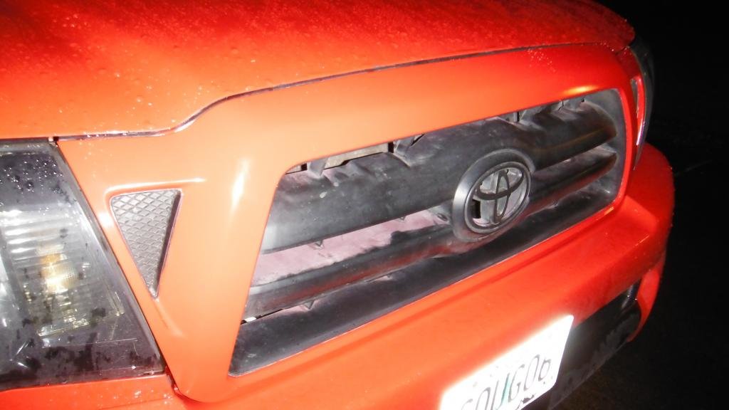

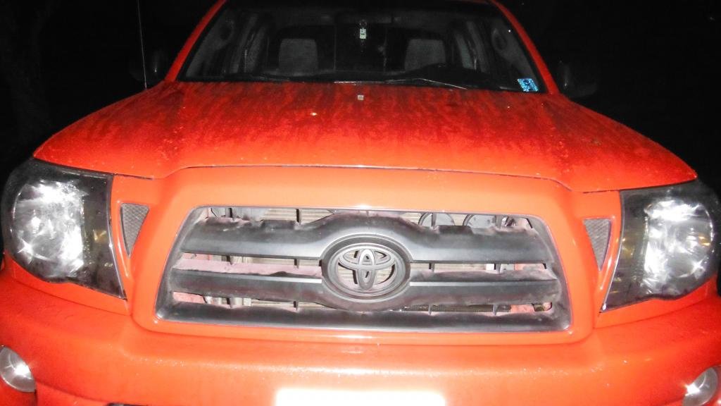

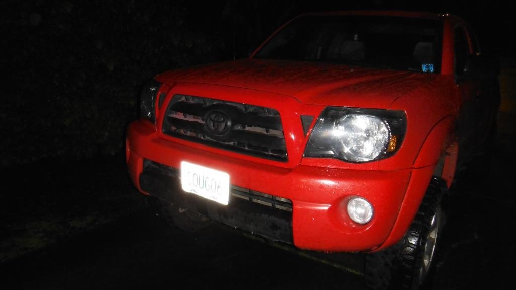

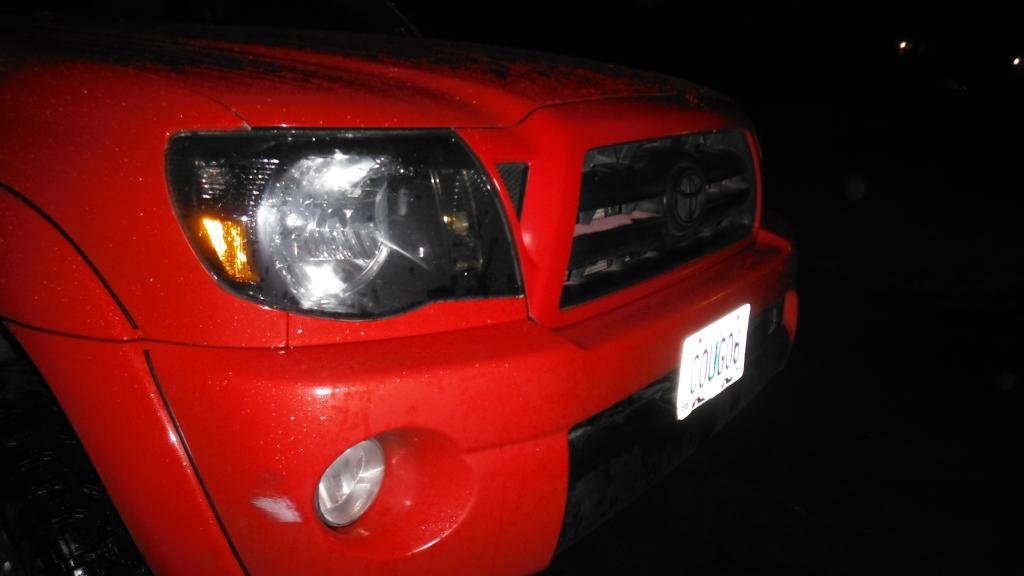

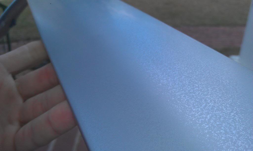

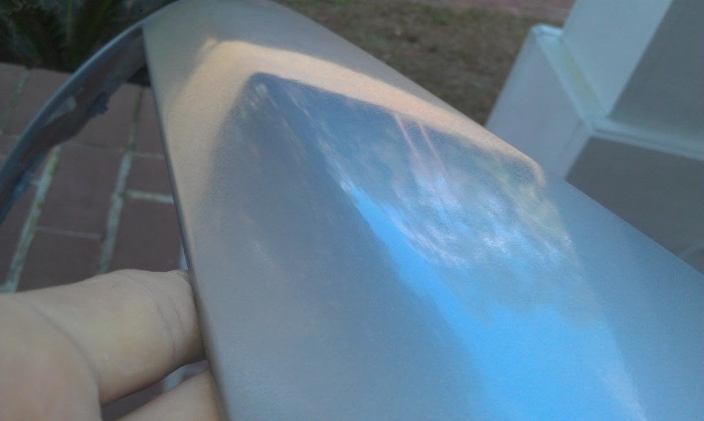

    I taped mine up and painted mine yesterday.
    Sanded
    Adhesion promotor
    Primer
    Sand
    Paint
    Sit for 3 hours then sand
    Another 2 coats of paint
    Sitting for 12 hours now and looks damn good. I can't wait to see how well it matches up
  18. Feb 22, 2013 at 7:35 PM
    #58
    Mitch
    Mitch Somebody call for a Wambulance?
    Jun 27, 2011
    #58964
    5,629
    Mitch
    Spokane, WA
    2007 Access Cab SR5 4x4
    Lights, Siren, Drugs, Needles, Electricity
    So I couldn't wait. I put a coat of wax on before I installed. At least right now (in low light) I am very happy with the results.
