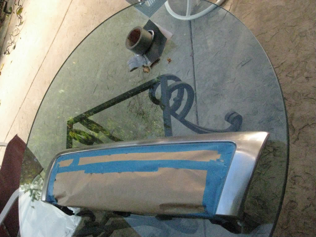

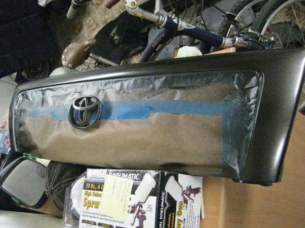

    I just did this last night on my 98... the hardest part was getting it off because the clips on the bottom where hard to get to and squeeze in so I could take it off the truck. After I got it off, I masked off everything I didn't want paint on, sanded and spray painted with rustoleum metallic black paint. The whole process took me an hour and a half give or take...
    The catch to this is that you have to remove the shine "completely" with the sand paper. I used 150 grit to rough it up a bit, cross hatching the patterns to ensure complete sanding and then finish sanded with 180 grit in a uniform direction to hide cross hatching marks... When your done sanding, it'll look fuzzy/bury and not mirror like anymore, but will still have a sheen to it. After sanding, I wiped down with mineral spirits to remove dust, debris, any wax or grease and I let it dry off and then sprayed.
    Before: IMG_3015_2ef9e3cc6592a12147d75cf7bdaf41c9e75b49dc.jpg
    After:

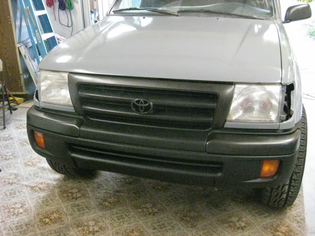

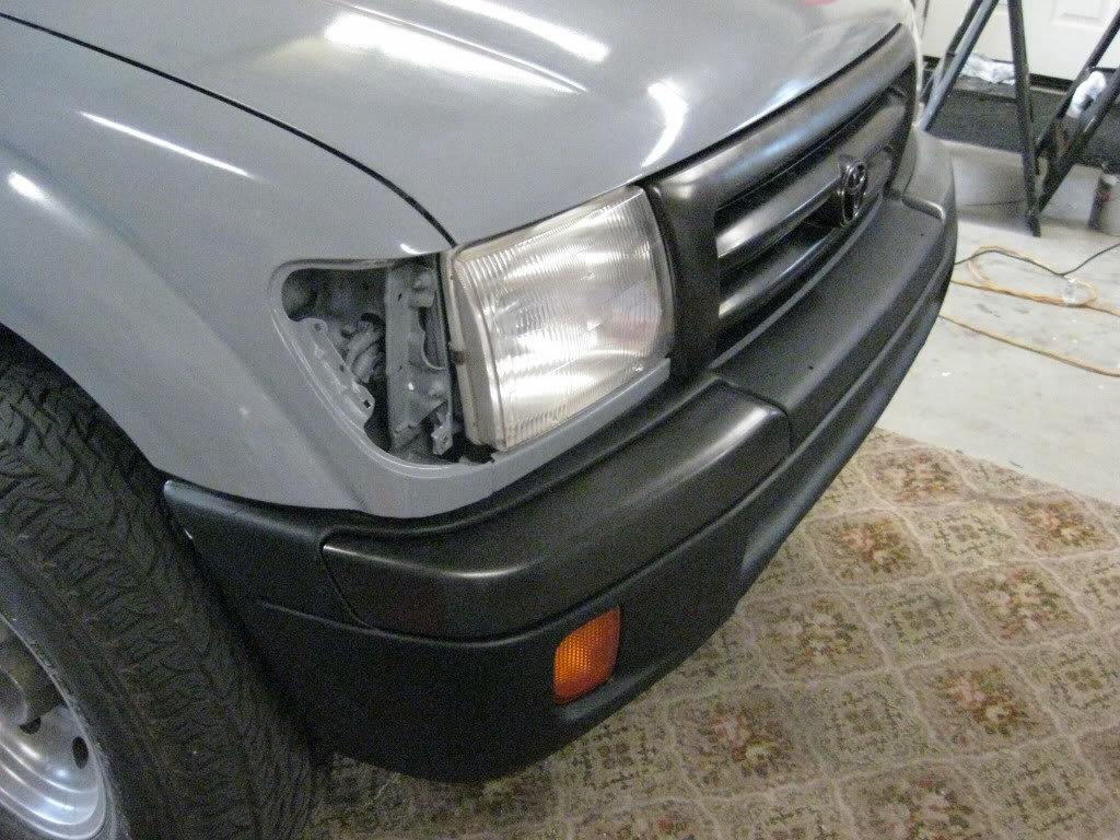

    Here it is: Before and after shots of the front end - I broke the clips on the corner lights taking them off (old and brittle)
    IMG_3017-1_37e079363843e21656d2acf02a3abc96288d90ce.jpgIMG_3022_82f5417047b382f3ae446ac1cd0d80e2d8e274d9.jpgIMG_3025_39955de2de06c02617f19bb62a06a8ff51362b6f.jpg

    Did you use a clear coat after or just the metaillic paint?

    no clear coat - just the metallic paint and some wax after 30 days. It's holding up well.
