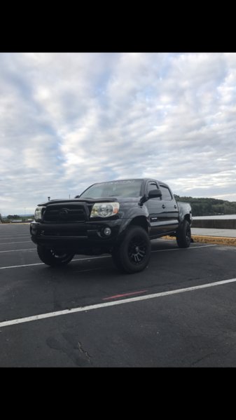

    I wanted to paint the outside of my grille the chrome part into white, so I need a certain kind of spray paint and do I need to sand it or can I just got at it? Anyone advice would be awesome, this is the only picture I have lol but the yota (obviously) but the outer part of the grille!
