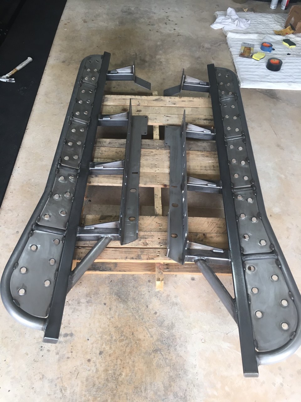

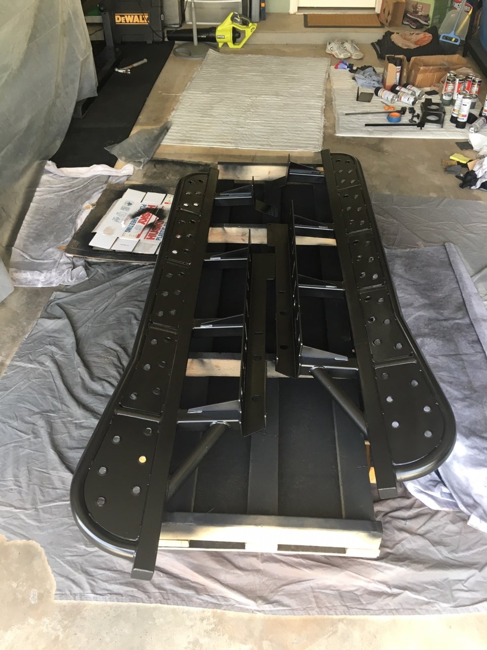

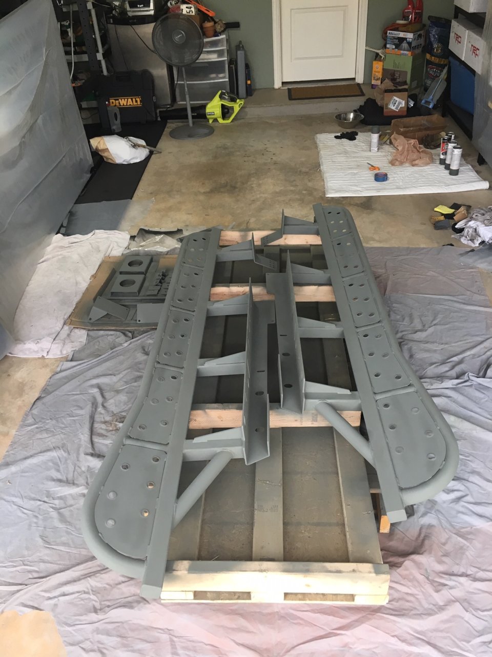

    2018 OR 4x4 DCSB
    @Mobtown Offroad can answer best, but I think they stopped shipping larger items powder coated due to issues.
    I thought the same thing, then spent around 12 hours cleaning, prepping, and painting. I did try to paint them when it was absurdly humid (was trying to get them on the truck before a road trip), but all in all I wish I would've taken them to a local shop to get powdercoated.
    Edit: No one asked but here are pics of the sliders prepped, primed, and painted

    indoomitable
    indoomitable Baby-steppin' down the stairs
    Dec 7, 2019
    #312775
    992
    Texas
    2018 OR 4x4 DCSB
    It was mostly the time involved, but I also wasnt very happy with how the finish came out. Im a bit OCD though. The underside has a few areas where the paint ran some and on 2 of the corners the paint has already started to peel back but I think thats mostly due to how humid it was while I was painting and the coats not drying properly. The “defects” are on the underside though so I try not to think about it too much.
    But I guess the main thing is I didnt expect it to take 12 hours, and while the finished product isnt terrible in retrospect I would have gladly paid a shop a couple hundred to save the time and the gallons of sweat lost.
