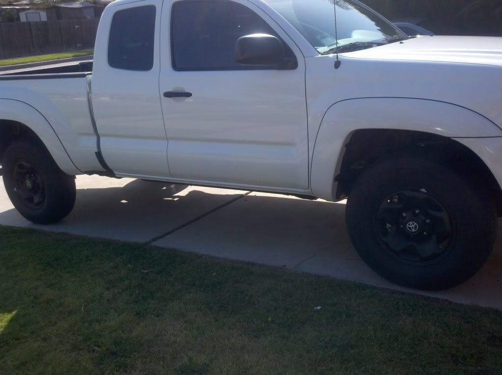

    the list is growing
    Wooo.... shes a work in progress...
    Plasti-dip... not paint.

    Do you have any other shots? I had trouble making out the detail on the wheels. That looks sweet though - and you kept the Toyota emblem silver, which was something I was considering. Looks sharp!!

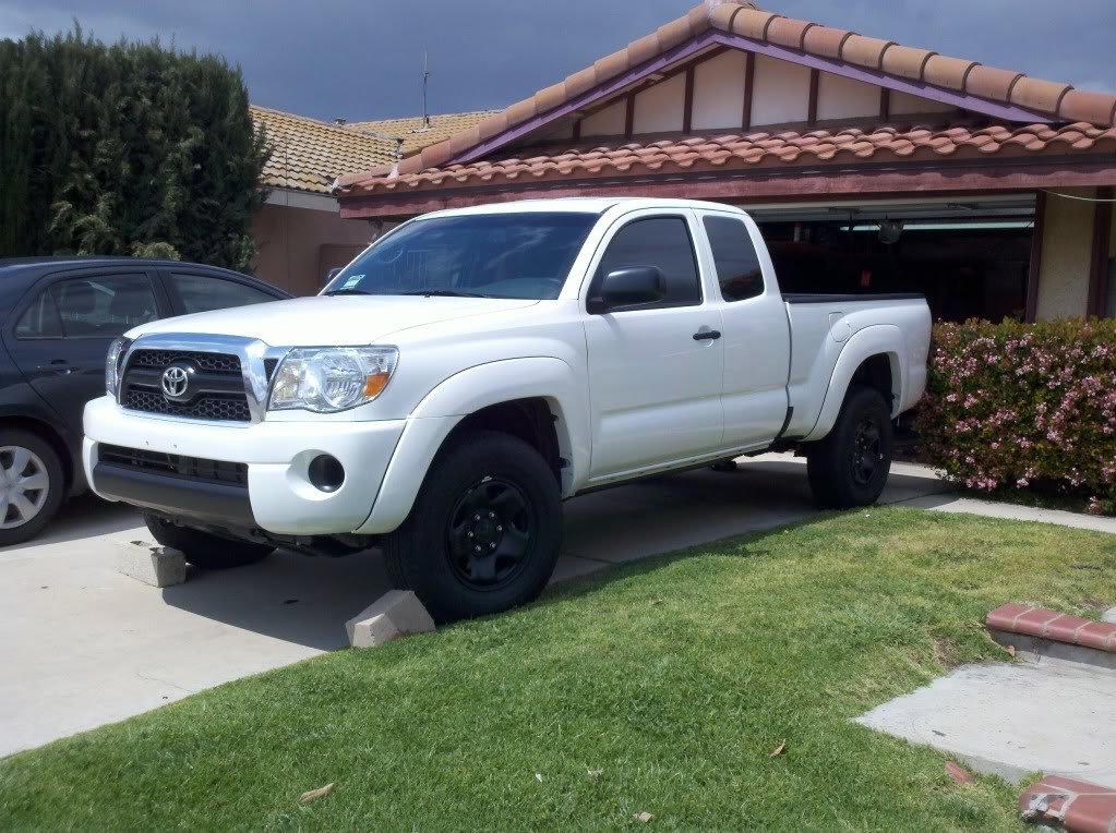

    I actually painted the center cap white before I put the plasti-dip on there. Then all I did was peel away the black on the inside of the logo. I had a hell of a time with my first 2 caps because I sprayed the white on too thick and I scored the dip too deep with a razor, I chipped the white paint and it flaked off when I pealed the dip. Once I got the hang of it though they came out real nice.

    That looks so sick! Those wheels look 100x times better. What is plasti-dip though?

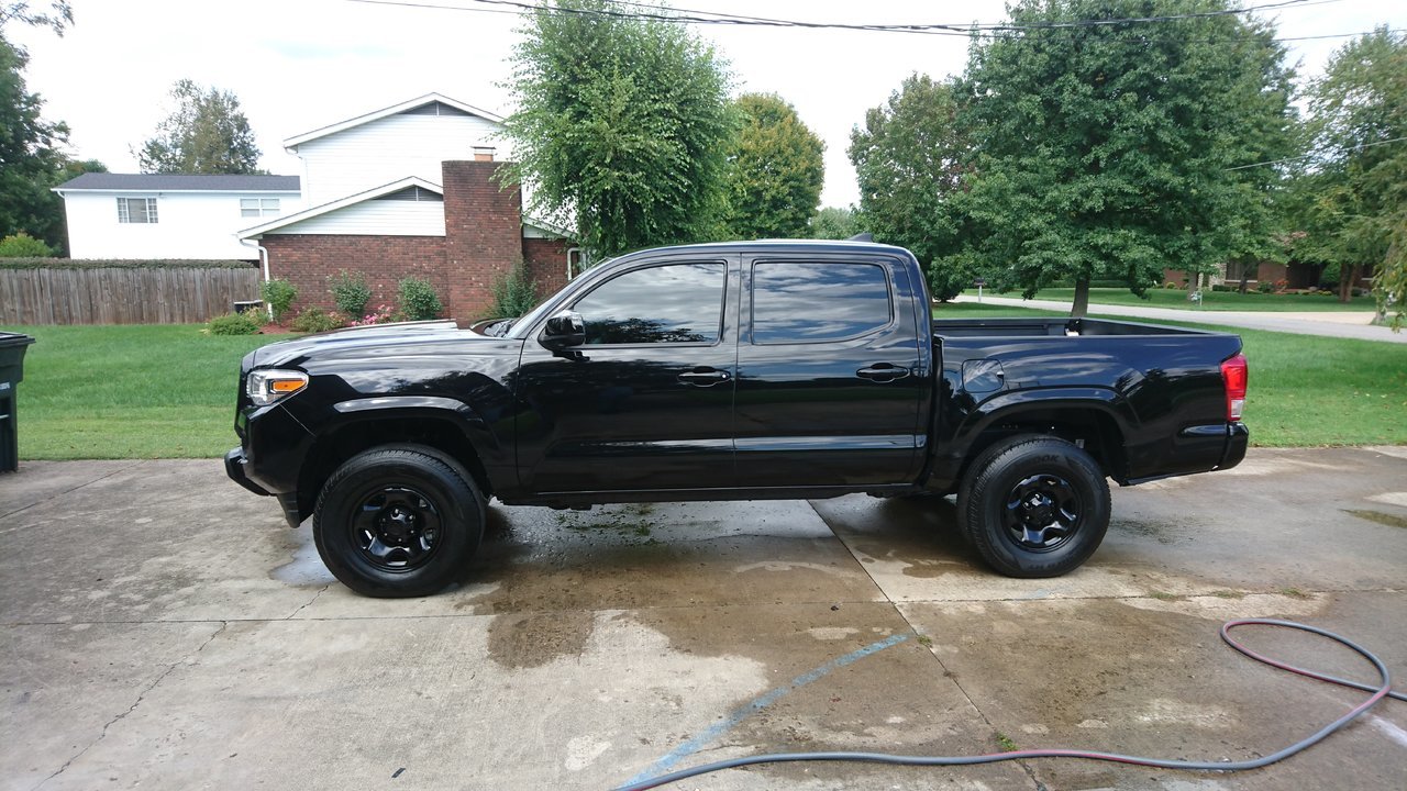

    I plastidipped my wheels a few weeks ago but I couldn't keep it from peeling off the lip of the wheel(just cleaned with alcohol and lightly sanded and cleaned with alcohol the second time) DSC_0575.jpg
    I liked the look but wanted more gloss so I said screw it, peeled wheels and am painting them with gloss black rust-oleum which I'm doing now more pics to come but I already like the glossy finish better.DSC_0587.jpg DSC_0589.jpgDSC_0588.jpg

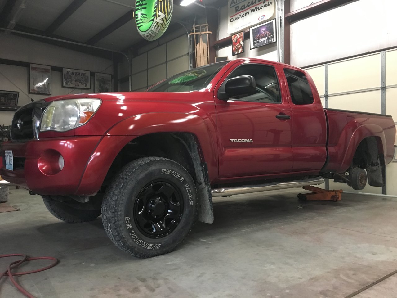

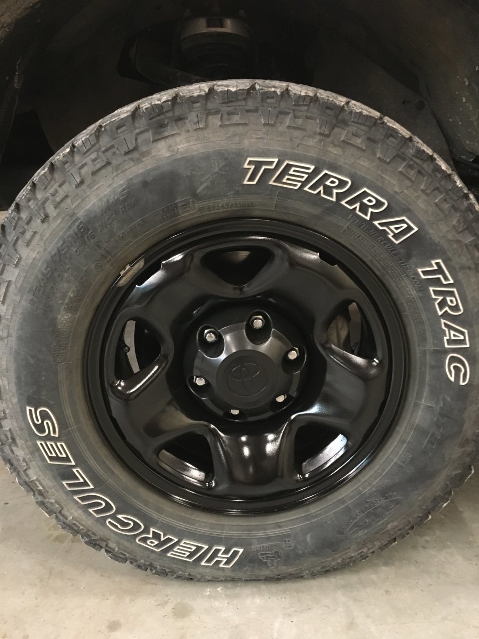

    Just got finished doing this to my steel wheels. So far I’m a big fan! I used duplicolor wheel paint instead of ruatoleum but everything else was the same process. Unfortunately I didn’t have a center cap on tight as it should’ve been and lost it on my first drive with the newly painted wheels. If anyone knows a good place besides Amazon (theirs had questionable reviews) to pick up another cap I’d love the advice!

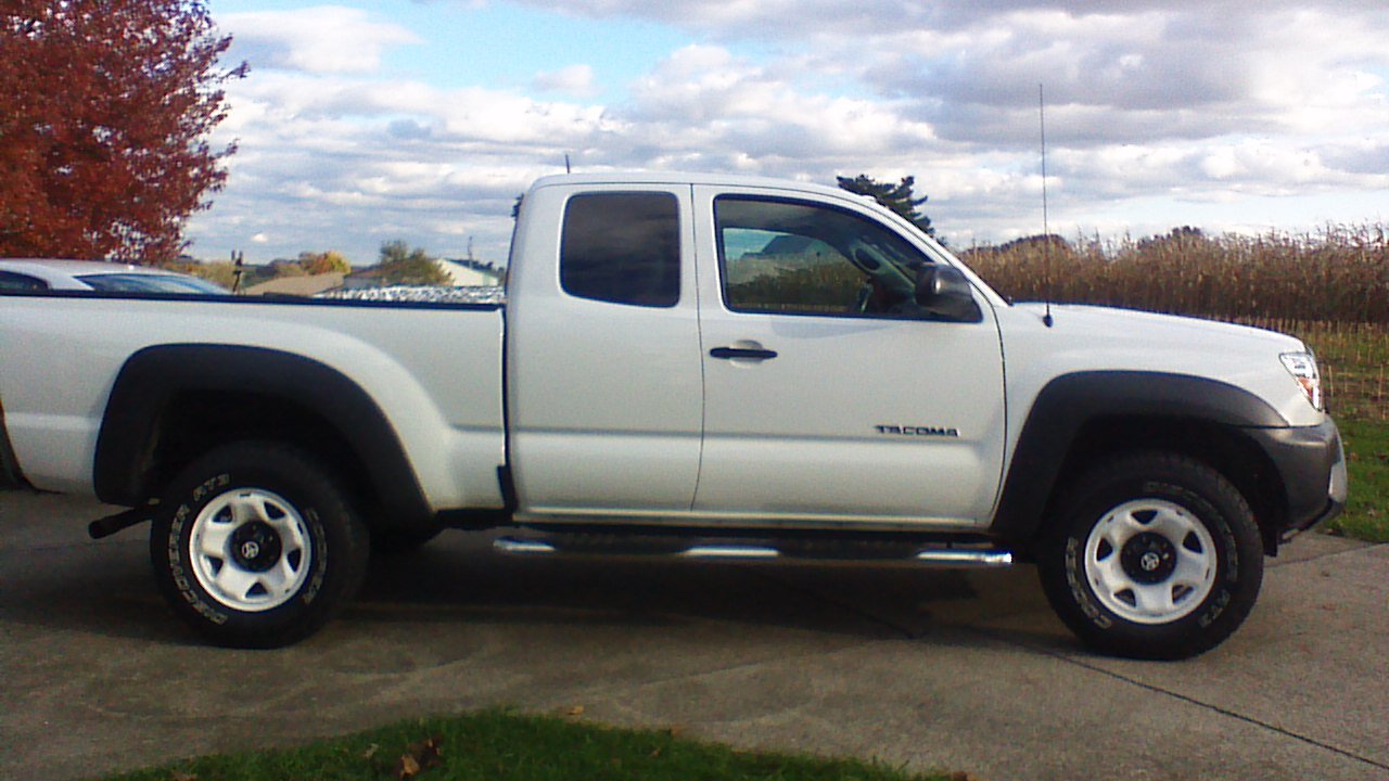

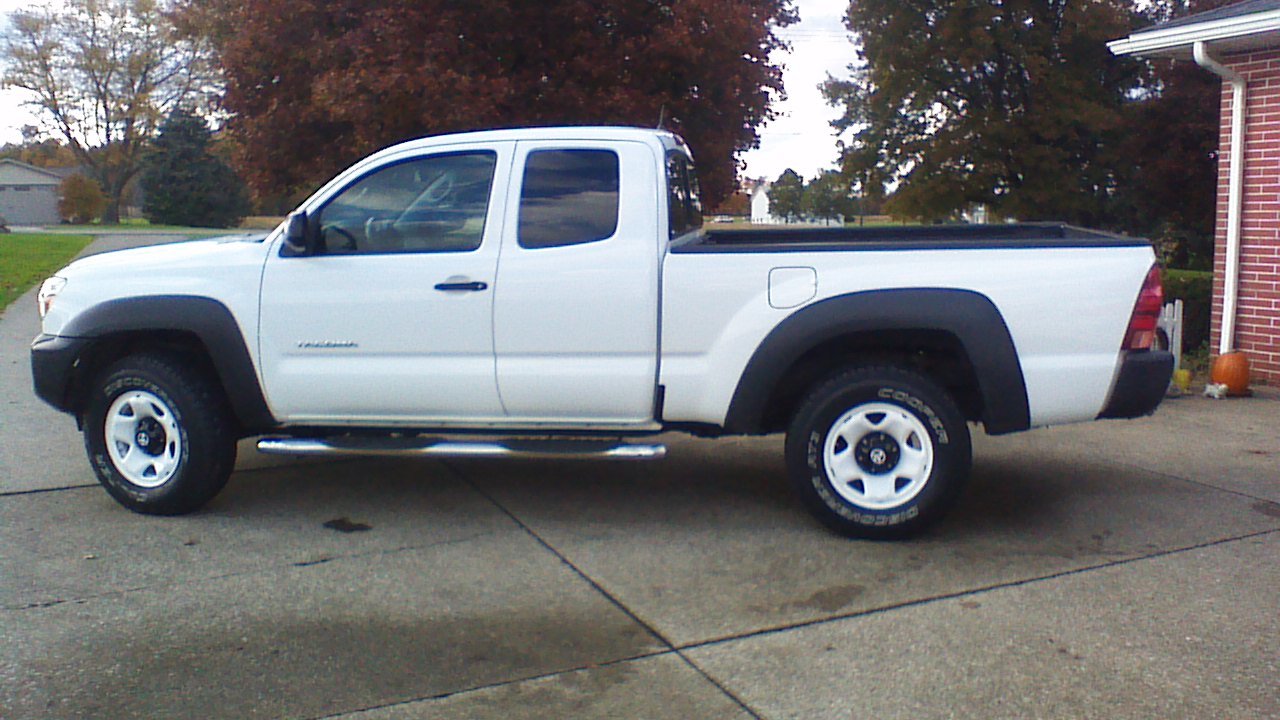

    WIN_20181103_163737.jpg Painting the logo in the middle of the cap really sets it off.

  16. Apr 19, 2019 at 7:06 PM
    #16
    Jaybird947
    Jaybird947 Active Member
    Dec 2, 2018
    #274612
    33
    Jay
    19 Tacoma SR Double Cab 4x4 Super White
    Are these pictures with the Rustoleom or plastidip?? Looks great!
  17. Apr 19, 2019 at 7:09 PM
    #17
    Taco505
    Taco505 Well-Known Member
    Feb 15, 2009
    #13659
    3,570
    Alex
    New Mexico
    2011 4cyl 4x4 5 speed
    OME 884's/90021, MD Dakar/Nitrocharger.
    That looks damn good!! Do you have a pic of the full truck with them on?
  18. Apr 19, 2019 at 7:43 PM
    #18
    Tacosail
    Tacosail Well-Known Member
    Feb 24, 2017
    #211525
    374
    Jerry
    Hermanville Heights, Ohio
    '13 white ACLB
    '17 wheels,int. Wipers , bed mat , relocate trailer plug , husky floor liners , Lund nerf bars, wet Okole seat covers- heat & lumbar.

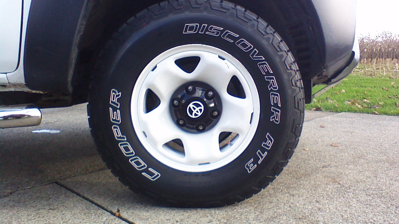

    Might have one or two.
  19. Apr 28, 2019 at 3:38 PM
    #19
    Falconsfan
    Falconsfan Well-Known Member
    Aug 13, 2017
    #226735
    547
    2017 sr dcsb v6 4x4 black

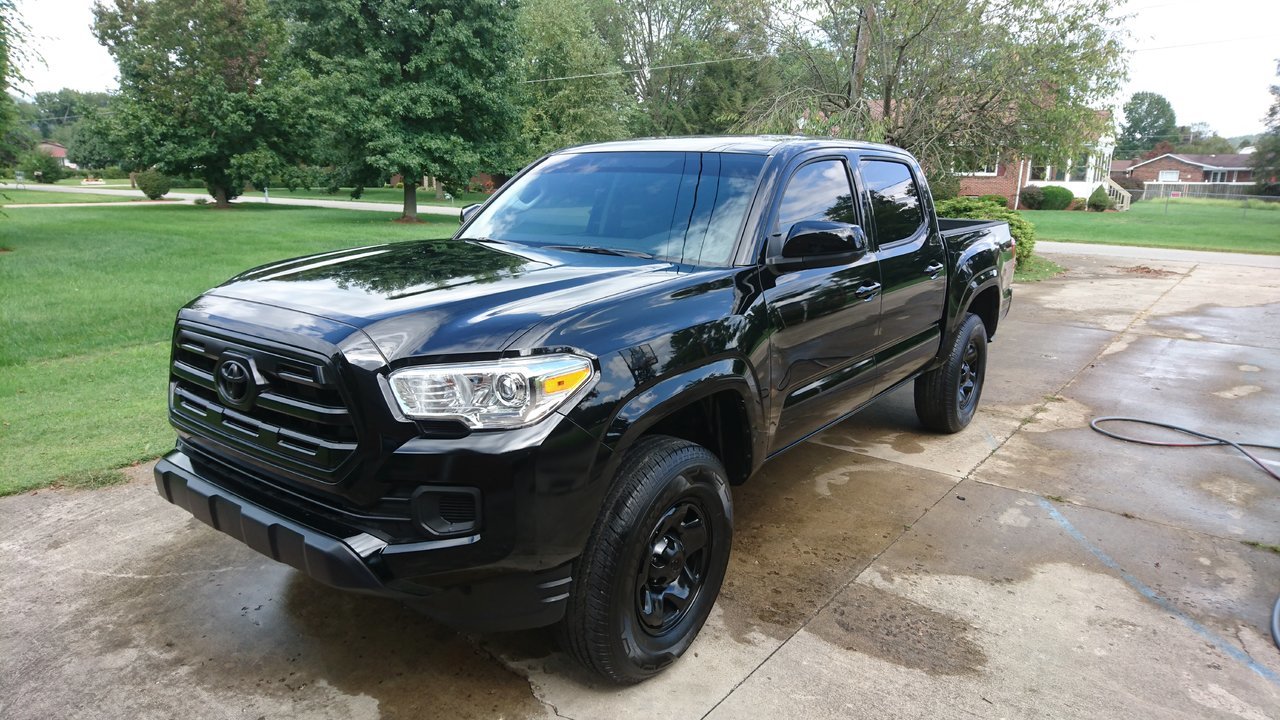

    This is the paint, the plastic dip didn't stay on but for about a week so I could get to the weekend and redo it.
    Jaybird947[QUOTED] likes this.
  20. Apr 28, 2019 at 4:16 PM
    #20
    Jaybird947
    Dec 2, 2018
    #274612
    33
    Jay
    Looks great. Did you rattle can clear over it also?
