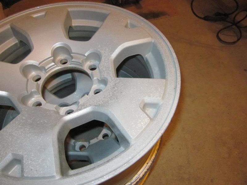

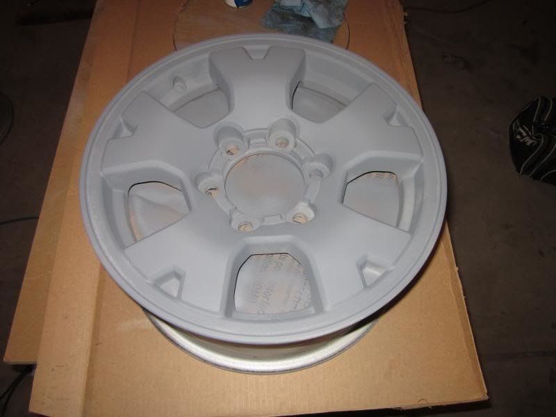

    I painted the first gen alloy rims so same thing as the 2nd gen in terms of finish, and alloy (for the most part). They had a lot of spotting and corrosion. I used a wire wheel to get most of the flakes off and then worked my way from a rough sandpaper down to a fine sandpaper.
    Before
    getting there
    kinda before and after. Still have to clear coat
    I was looking at $100 per wheel to get professionally done. For less than $50 I painted all 5 wheels, that I got for less than $200. Saved a bunch, can be touched up when they get chipped on stuff. Money for other stuff :)

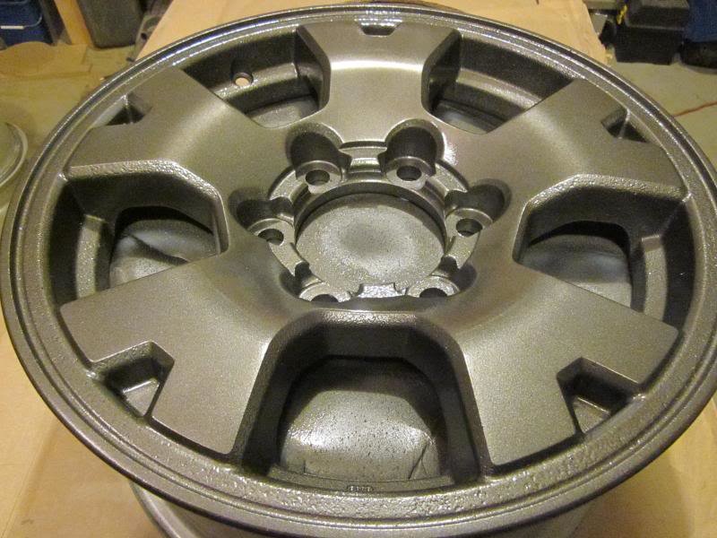

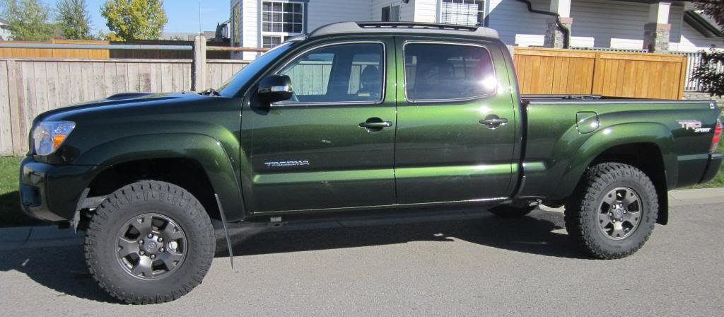

    I took mine to a sketchy sandblaster (no word of a lie, run out of a van in a gravel yard by a guy from "Deliverance", I'm sure). He panicked when he saw the rims flaking, thinking it was the aluminum coming apart:
    Turns out it was just the coating. Very tough coating, by the way. So, I liked the way the edges looked with the chipping and ended up sanding just the spokes. A couple coats of etching primer and you get this:
    Then three coats of Duplicolor rim paint, followed by three coats of Duplicolor clear coat and you get this:
    If you look closely, you can see the textured finish on the sides of the spokes and the lip of the rim, left by the sandblasting. I like it because it's subtle.
    Removed the logos from the center caps by melting the three little tabs on the back with my soldering iron. Scuffed the caps with Scotchbrite, used a plastic primer on them, and followed the same three coats paint/three coats clear routine as the rims. Replaced the logos and melted the tabs back in place, again using the soldering iron.
    All in all, took the better part of a day to do this, but I like the look. Toyota factory 16" rims, but different from everyone else :)
