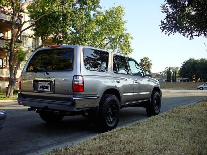

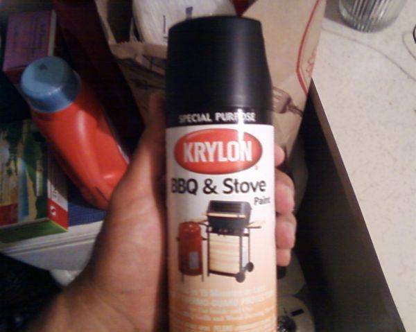

    i used krylon high temp grill paint:D.

    Wow! nice!...i want my stock to like look that...so did you at least use a primer?

    nope:D and just did 1 coat:eek:
