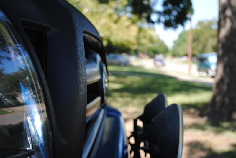

  12. Mar 19, 2015 at 6:25 PM
    #132
    itzyoboipaul
    itzyoboipaul Well-Known Member
    Jul 18, 2013
    #108518
    2,920
    Paul
    PFville, TX
    2020 TRD OR Cement
    did mine today
    using duplicolor from auto zone
