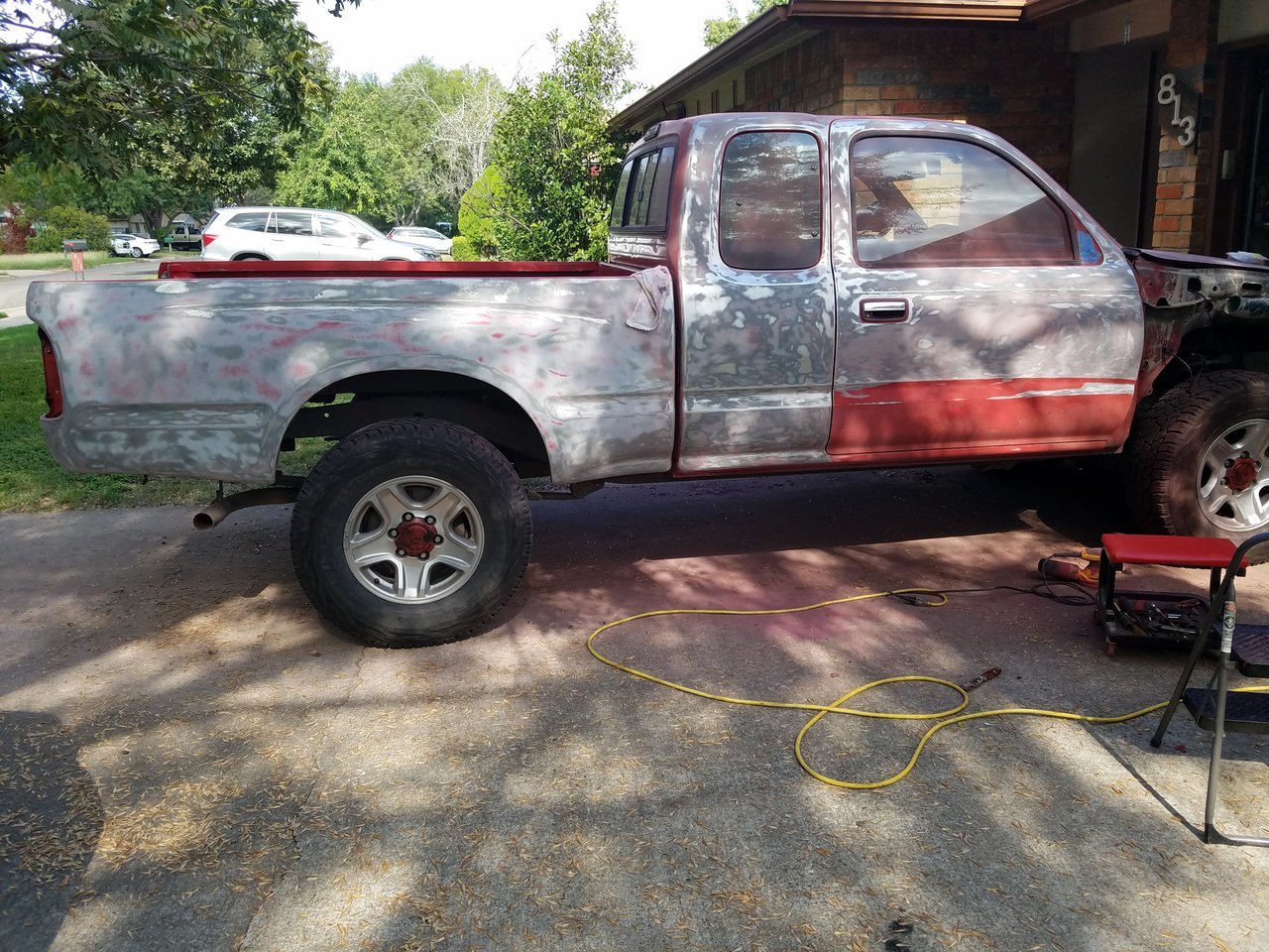

    I finally got tired of my clear coat flaking off so I'm in the process of Raptor lining the whole truck with the red-tinted liner to match the old color. I'm by far not a body and paint guy but learning along the way.
