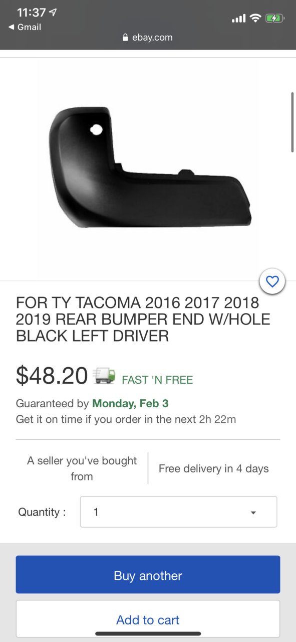

    Would primer still be advisable for unpainted surfaces? Purchased an aftermarket replacement bumper that is plain black. Going to hit it with duplicolor mgm and clear coat
    Wondering if I need primer if there is no paint on it to begin with for this rear plastic third gen bumper.

    Is this a front (plastic) or rear (metal) bumper we're talking here?

    It is a 3rd gen rear plastic bumper.

    Ah, I see. Typically for plastic you'll need to first scuff it, followed by spraying it with adhesion promoter, primer, base coat, then clear.

    Here's a test for determining what you have on the piece you purchased. Use a very light grit, 400 or finer. LIGHTLY scuff the surface for a few seconds. If you get a dust that comes off it is already primed. If you don't get any dust, then it is what is called raw plastic, and an adhesion promoter will be required.

    Usually type of plastic is stamped on back of part . Some plastics need different adhesion promoter . With that bumper piece thinking regular plastic adhesion would work . Scotch brite pads do seem to work better .
