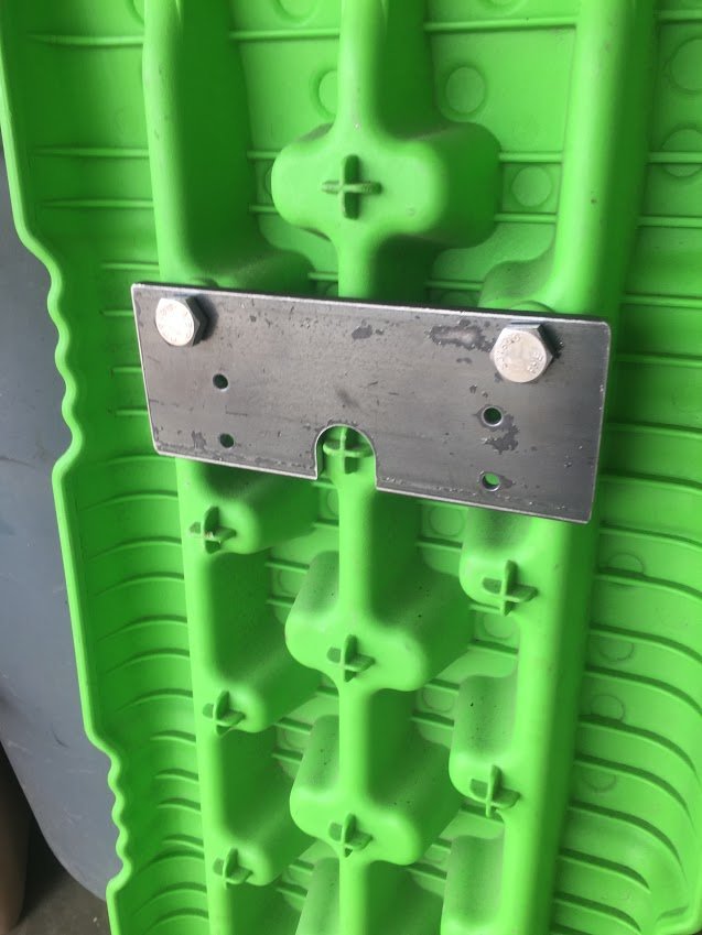

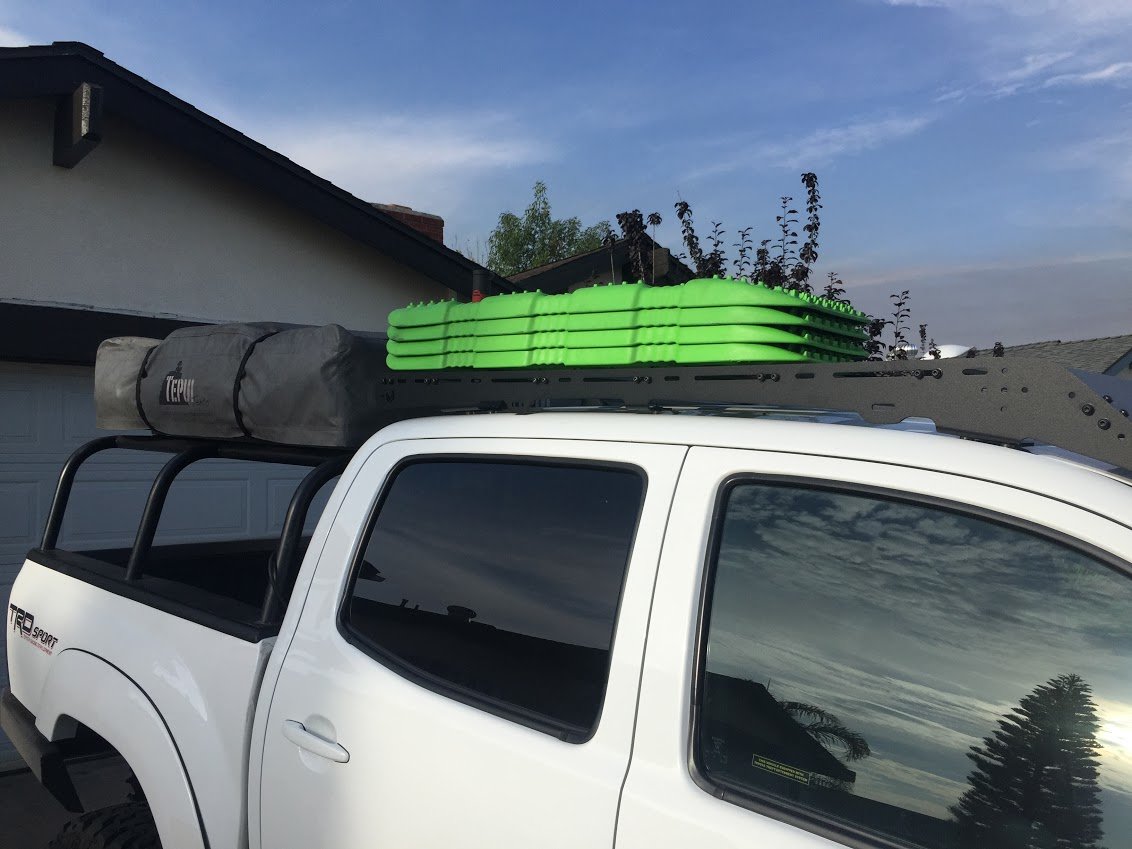

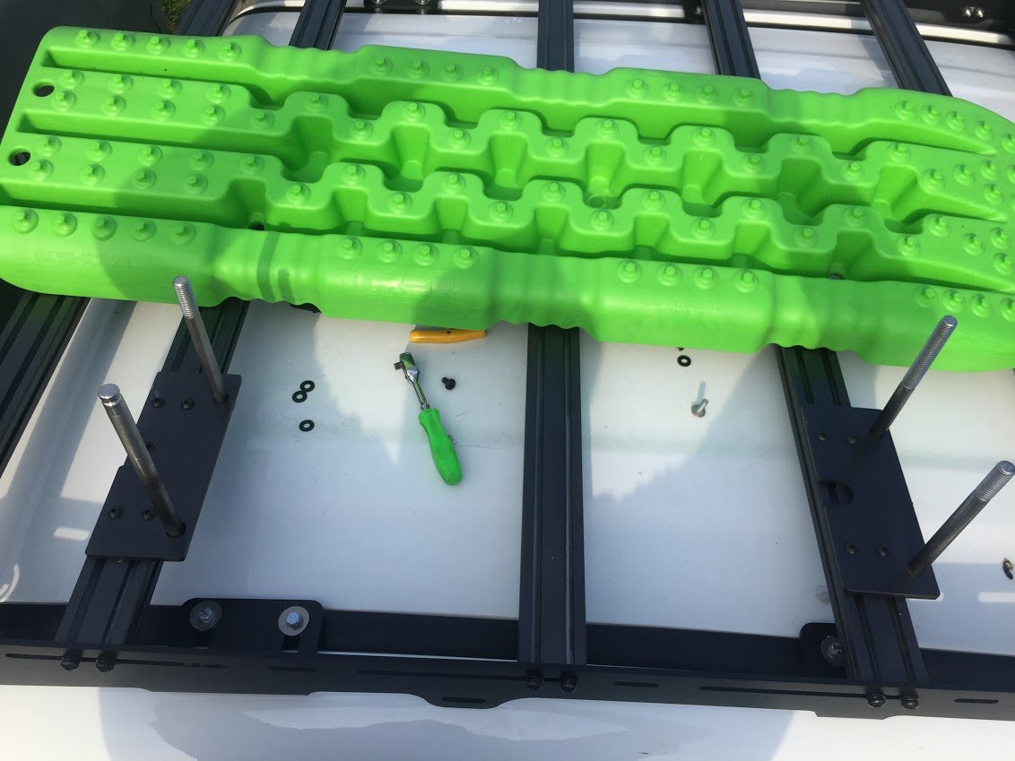

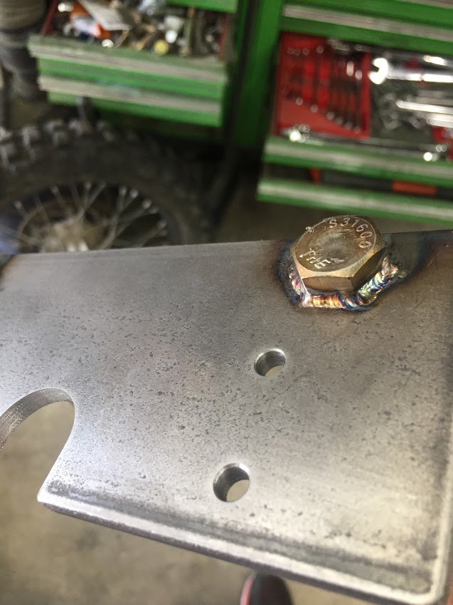

    I didnt like the factory TRED mounts and how it only allowed to hold 2 treds and i didnt like the lock setup.
    so i went and made my own.
    started with some plate steel and some stainless bolts
    welded them up

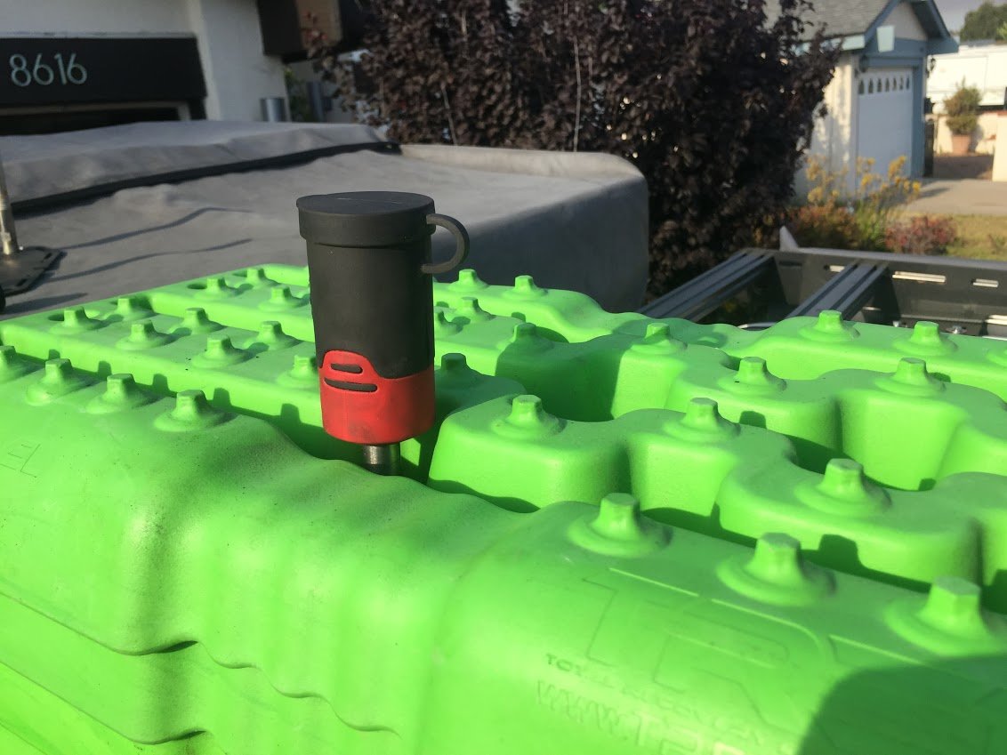

    to make it lock easy, i used a bolt lock which uses your factory key, i cut up the shaft and welded it the end of a cut stainless bolt.
    looks like this (bottom left)
    and locked
    and all done :D

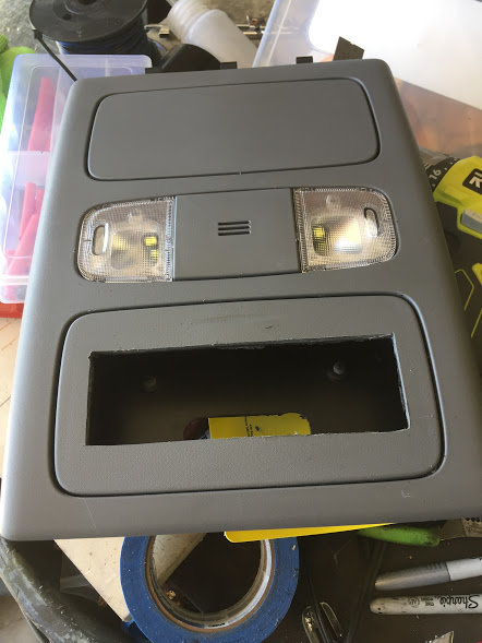

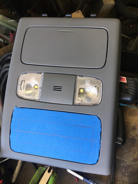

    you mean something like this? :D i just started this on sunday. As for a fuse setup, i am a fan of the bussman one that i use. 5 relays all in one box.
    first take it out of the truck and protect it some.
    then cut a nice hole
    and installed.

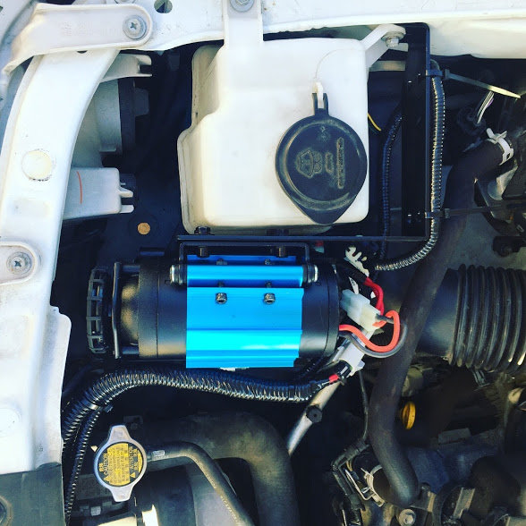

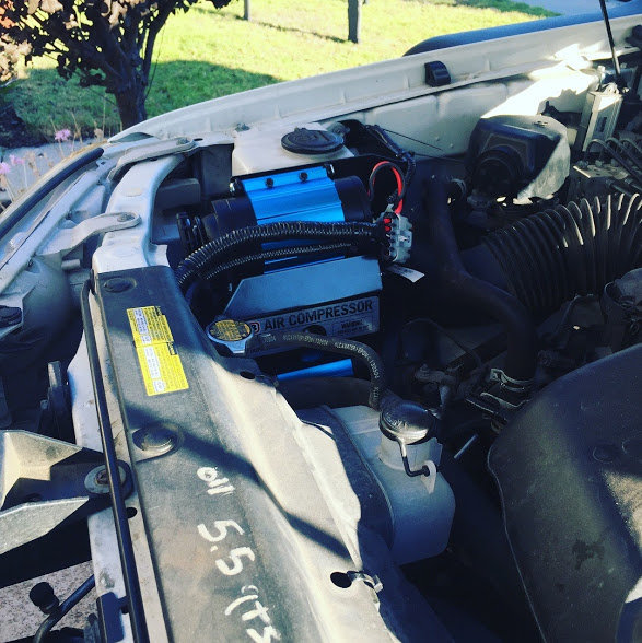

    Picked up a ARB dual compressor setup and a Slee offfroad bracket. super slick setup.

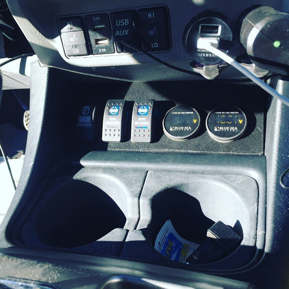

    also, installed all three switches for when i do get the lockers lol. also you can see the dual voltage gauges, one for the house battery and one for the starting battery.

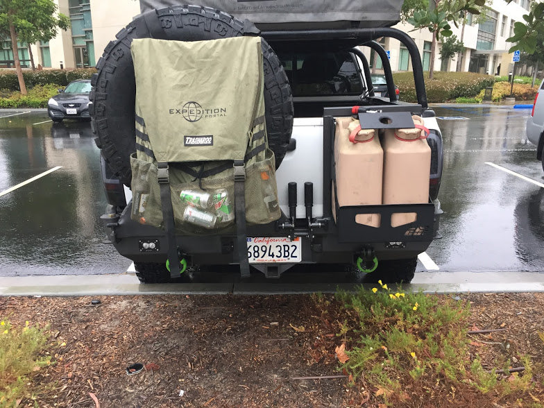

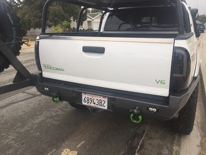

    picked up a high clearance rear bumper and made up a custom dual swing out to hold fuel cans and my spare tire.
    Installed some sweet Baja Designs backup lights.
    and the rear swing out.

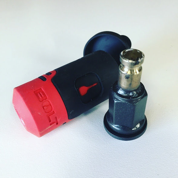

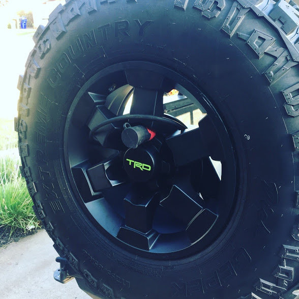

    needed a good way to lock the wheel so made up a custom lug nut with a bolt lock end. quick work on the lathe and some tig welding :D

    Found it! Who’s rear bumper did you purchase?

    I am in the mira mesa area. i used the pelfrey built rear bumper but i wouldnt do that again lol

    Where did you find those seat heater switches?

    was a generic kit on Amazon for a seat heater setup for a tacoma

    Gotcha, so it wasn’t an issue with the product so much as the business practice? I’m just curious because I have a Pelfrey rear bumper and was planning on adding a seingout. Just wanted to see if you have any structural issues.

    i did add some extra structure to the brackets as you know they are only side mounting, i added brackets to bolt to the bottom of the frame also.

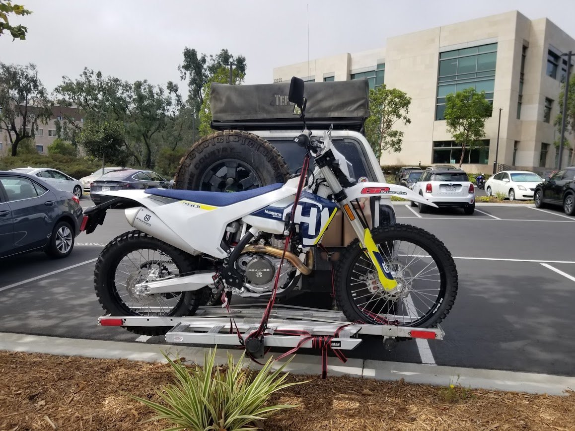

    i also added in some extra receiver tubing for a bike rack.
