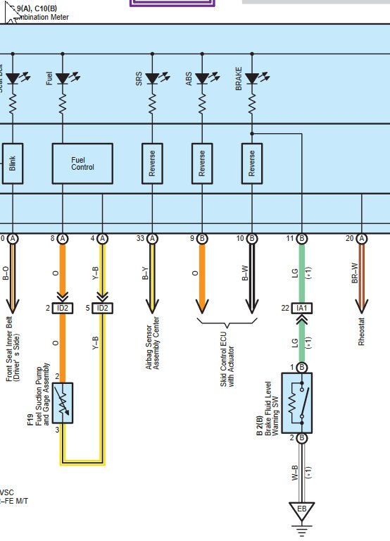

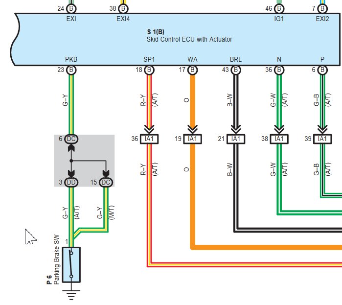

    I'll assume that you don't have an ABS Light on the dash illuminated and just the Brake LED is on and beeping.
    The first two things to check would be the switch on the parking brake actuator.
    Also check the Brake Master Cylinder fluid level.
    See the prints below.

    The parking brake switch being unplugged could be an issue. If you look at the drawing provided above it should be a normally closed switch. With it unplugged it would be the same as with the parking brake engaged, open circuit which would cause the beeping and alarm.
    If the master cylinder is topped up, I would suspect the parking brake switch.

    Get a Digital Multimeter and test the wires on the switch for continuity. It should read OL ( open circuit ) when the brake is actuated and closed zero ohms when the switch is not actuated.

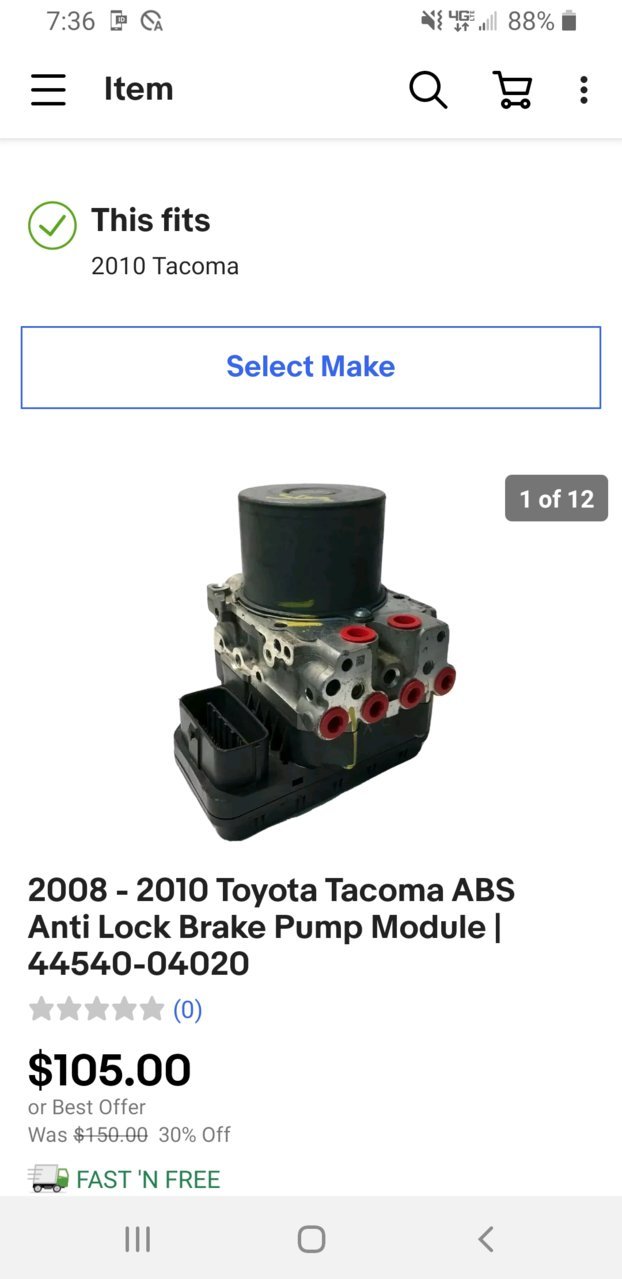

    Is this what I need?

    Looks correct. I would compare the part numbers to make sure or at least get a return policy with the seller.
