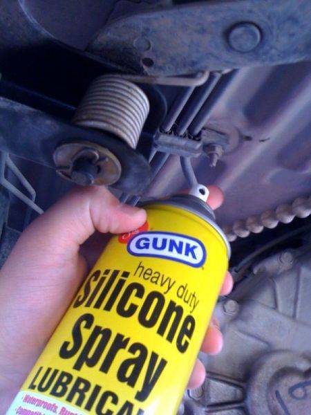

    I have a 2001 Tacoma 2x Reg cab. For a while now, my brake light on the dashboard would light-up every time I hit a bump in the road. So instead of using WD-40, I used an Orange Cleaner which smells a whole lot better. I sprayed down all of the mechanisms related to the Parking Brake Release under the dash. Worked!
