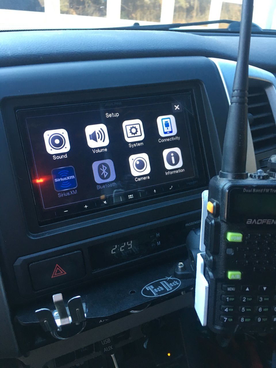

    I lied it needs to be cycled

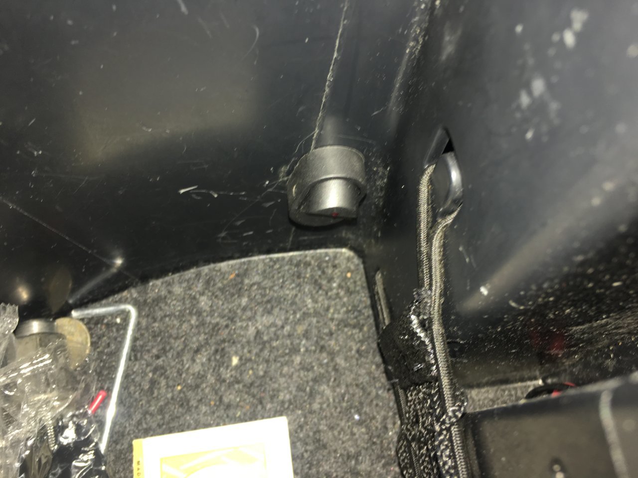

    Would a toggle switch work? I have an old one set up for bed lights i took out? I wonder if i could just cycle it on and off

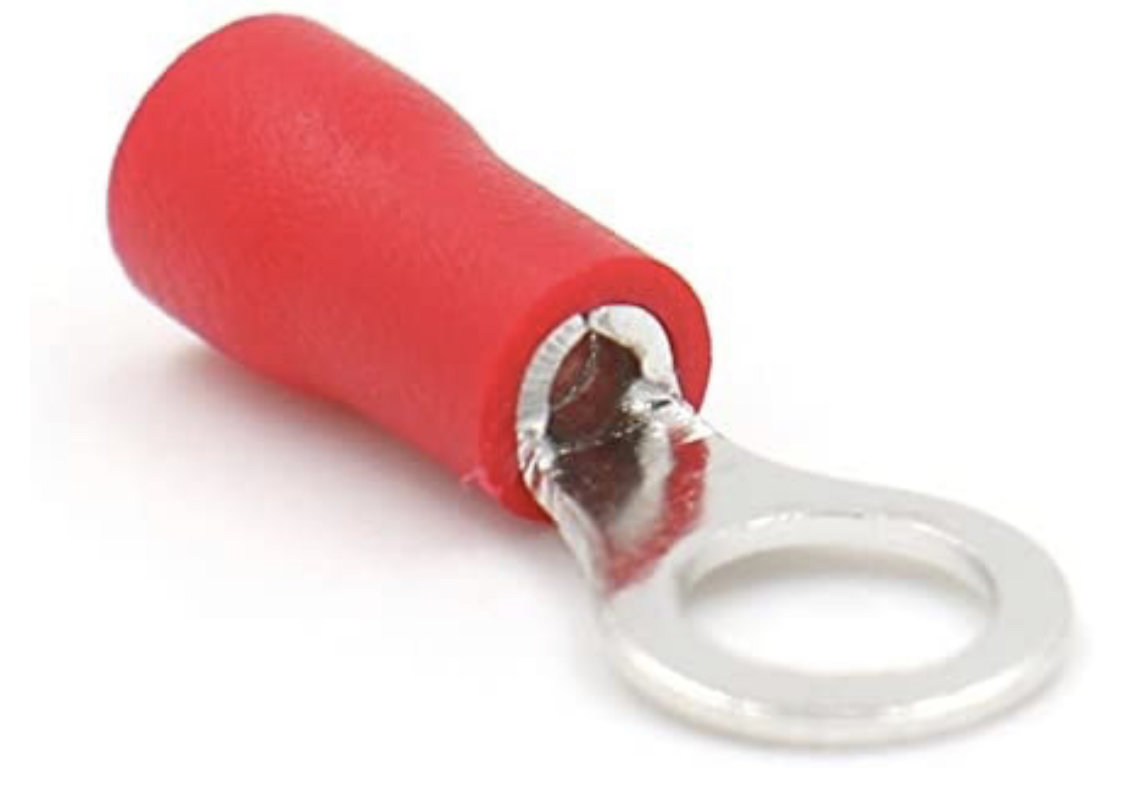

    Put one of these on the end of the wire and ground it to the head unit chassis using an existing chassis screw. DONE!20E40B42-4D7E-4F96-85A4-69430161DF50.jpg

    I tried that it needs to read ground no ground ground to work

    Any old toggle switch from the parking brake input to ground will do. I put one in one of the blanks under the radio.

    Yep that’s what I’m doing now it worked with my multimeter as the connection point so I’m thinking that’s the route I’ll take

    Toggle switch worked

    yes, this is the route to go if you have one laying around. connect one side to the alpine brake wire and the other side to ground and you're set. that will imitate the parking brake. just flip it on when you need to access settings and flip it off when you dont.
