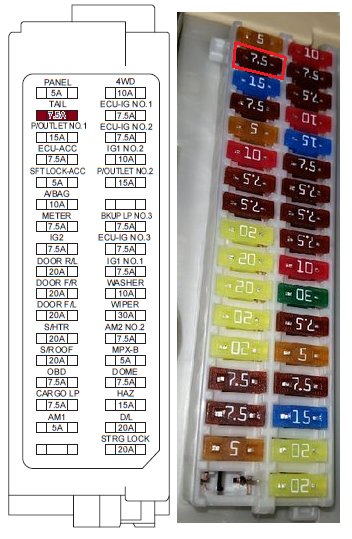

    Let's take one feature at a time. The Parking/Tails are a separate fuse. Get a new fuse. Remove the one in the cab fuse box with new one. Turn light stalk to parking/tails lights. Walk around the vehicle for a visual check.

    Yeah I checked the fuses pretty extensively and I’m fairly confident with fuses and basic wiring. I just haven’t busted open the steering column yet to check those wires. Was really hoping someone else had a similar past issue and could poof! Fixit.

    Let me double check that real quick! Definitely checked that fuse but didn’t switch it out with a new one. Read about that tail fuse causing problems.
