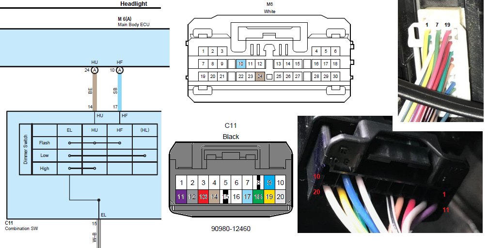

    Thanks for the response! When I switch to “parking lights” all I get is darkness on front and back, like an off switch.
    Also, the brights won’t click “on” but the flash works fine.
    No cut wires! Plug and play to under the dash and into the ignition. I’ll try that in the morning for sure. Takes about 15 minutes.

    Although, if I read this wrong or think about it differently, I might have inadvertently jacked up a wire while I was under there. If that’s what you mean, then yeah I’ll also check that.

    @caribe makaira , pulling back on the stalk activates brights but pushing forward doesn't?

    Same connector, but switch rotates (selector) and locks forward (High) and momentary pull (Flash)

    I’ll double check the ECU and the wires through the remote start I installed. I suspect (hope) that’s where it’ll be.
