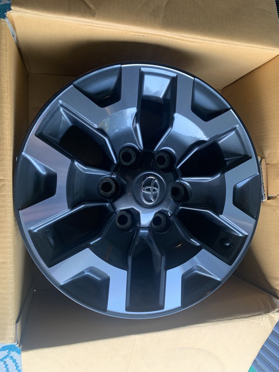

    upload_2023-8-9_5-38-46.jpg Can somebody provide the correct Toyota part numbers for lug nuts and TPMS sensors for installing these rims on my Gen 2 Tacoma?
    Or perhaps quality alternate part sources for these items.
    Thanks in advance, Lou.

    If you currently have alloy wheels on your 2nd gen, then just swap over the same TPMS and lug nuts for these wheels.
    If you currently have steel wheels then it may be a different story but that usually isn't the case. If it is, post back and someone can get you the numbers. Or go to parts.toyota.com and plug in your vehicle info and search for the parts to get Toyota P/Ns.

    Thank you.
    I currently have steel wheels.
    I will need the sensors and lug nuts.

    The lug nuts you will need are for the alloy wheels, you cannot use the lug nuts from the steel wheels. Tacoma alloy lug nuts are the shank style that have a built in washer. The lug nut size is 12X1.5, or 12MMX1.5. There are two types of lugnuts, the long deep style or the short style. Both styles will fit. The Toyota part number for the short style is 90084-94001 and the long style is 90942-01058. You can find a bunch of used sets on Ebay.
    You will also need TPMS sensors for a 2nd Gen (2005-2015) Tacoma with alloy wheels. TPMS sensors from a 3rd Gen (2016-2023) Tacoma will not work on a 2nd Gen. The part number for factory TPMS sensors for a 2nd Gen Tacoma alloy wheels is 42607-33021 PMV-107J. Here is thread with the info: https://www.tacomaworld.com/threads/new-alloy-wheels-and-tpms.473767/

    Thank you STOCKTRD
    Precisely what I was looking for.
    Thank you.
