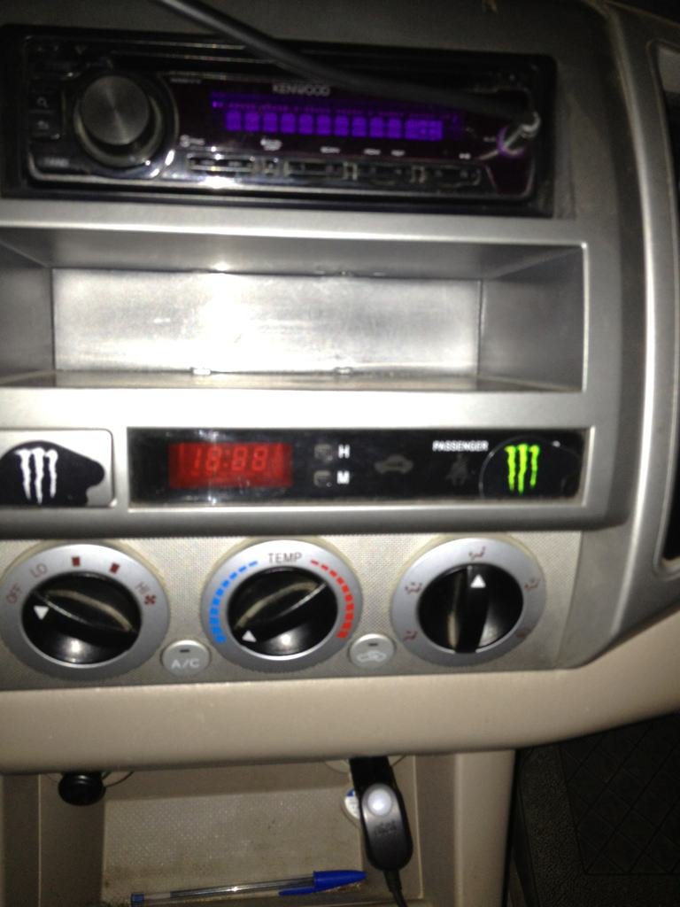

  9. Apr 25, 2012 at 8:47 PM
    BAMFTACO
    BAMFTACO Another day another beer
    Feb 3, 2010
    #30639
    10,907
    Juan
    Woodlandland hills , CA
    2007 Tacoma AC Prerunner
    Kings bruh
    c6e4d2bc-c577-86cb_385e4c95ae587508ed7cfbc9c08a4fa45d667424.jpgI just put a monster sticker on it cuz I'm so brap
