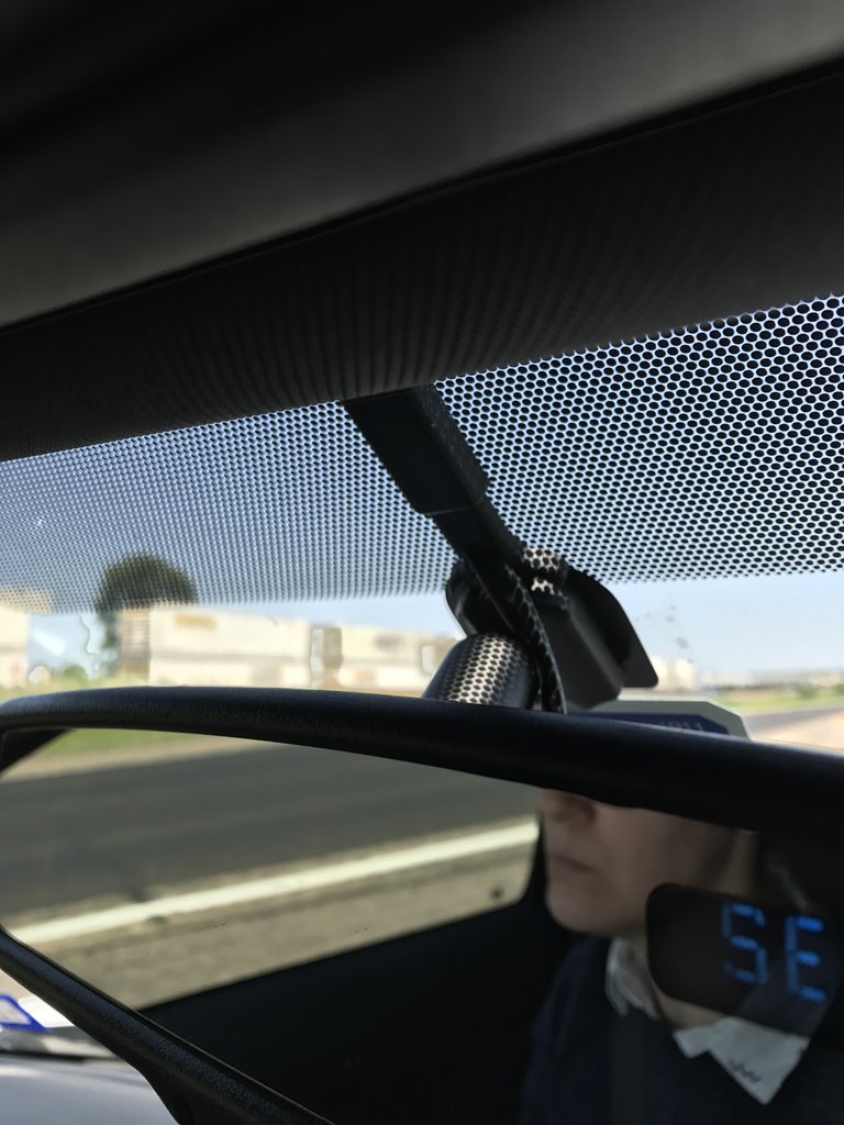

    I found Tacoma World searching google for a fix to the same rattle issue everyone else is reporting. Despite my belief that the rattle was coming from the passenger speaker cover, it was actually the wire cover on the review mirror. I loosened the sliding cover l just a little bit and the sound has disappeared permenantly. Most of the riders who I asked to listen for the noise including a Toyota tech swore it was coming from the middle of the dash though I swore it was the speaker cover. Just wanted to throw that out as it solved my issue immediately.
