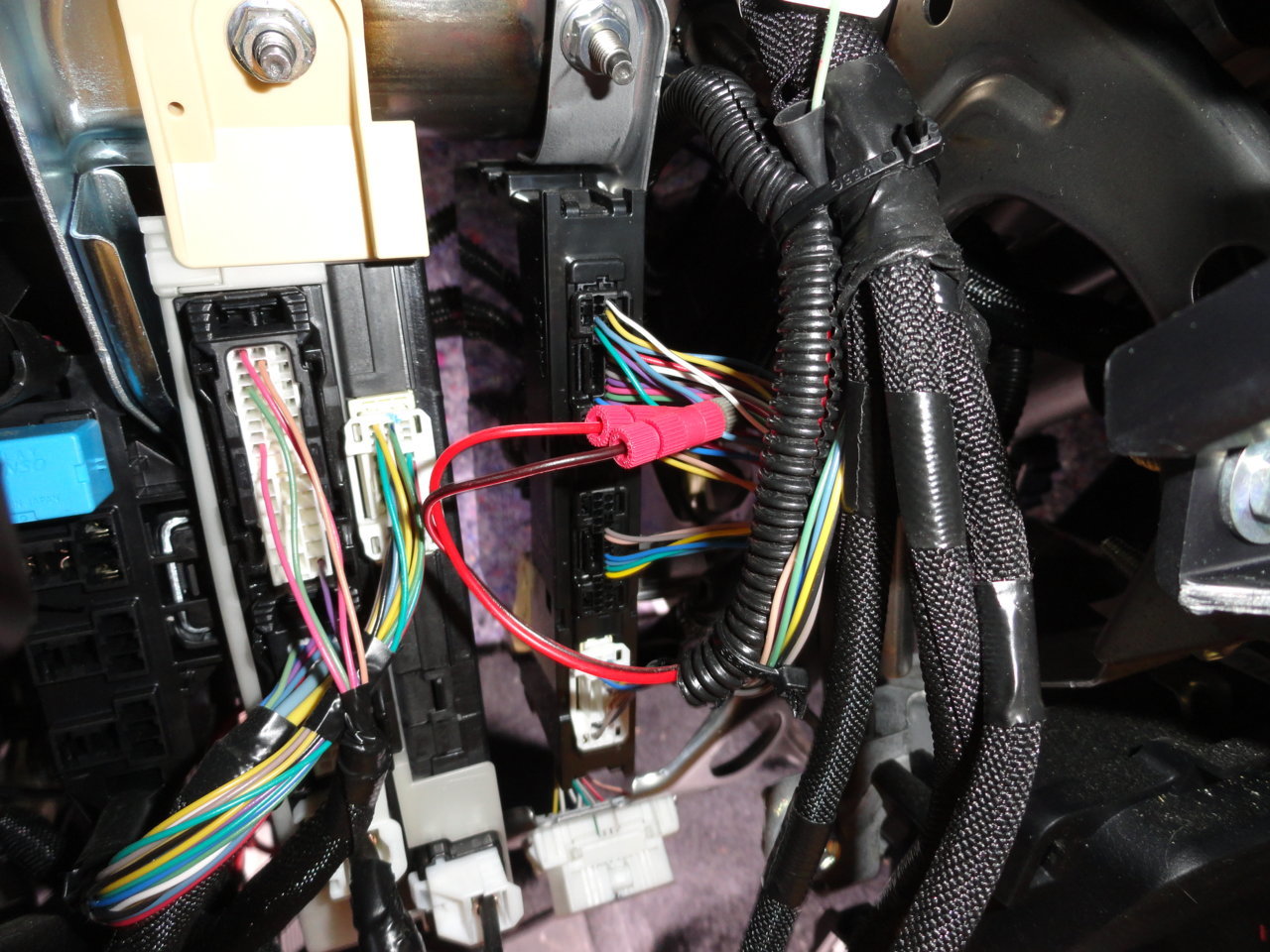

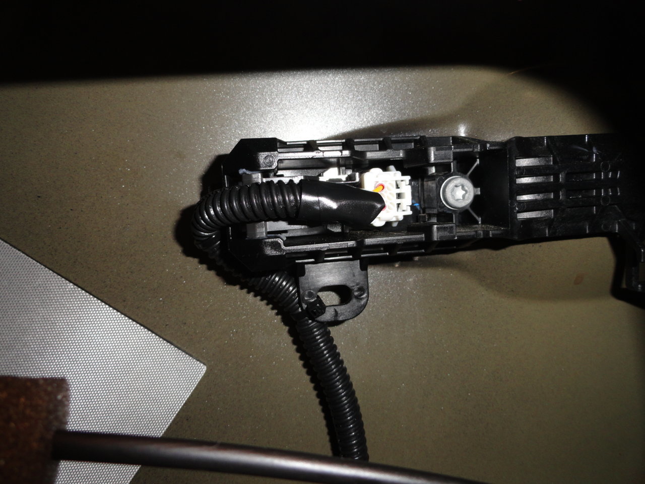

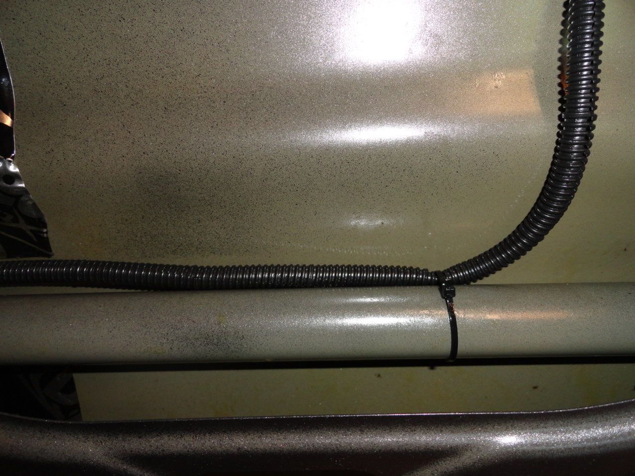

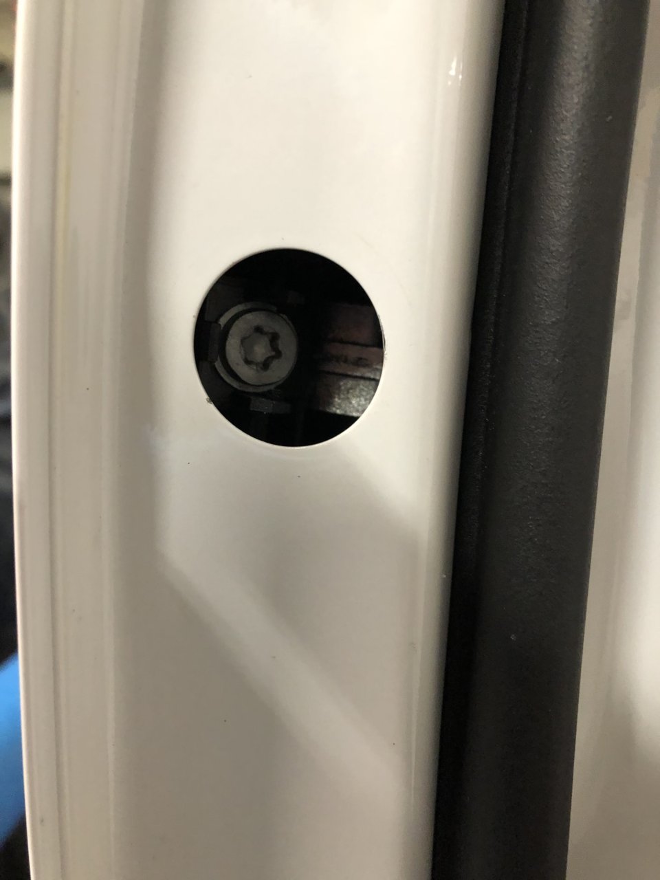

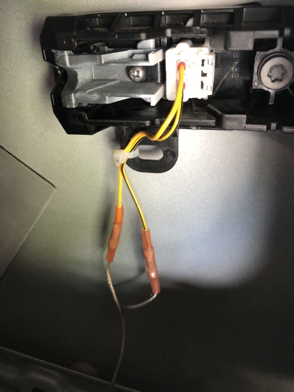

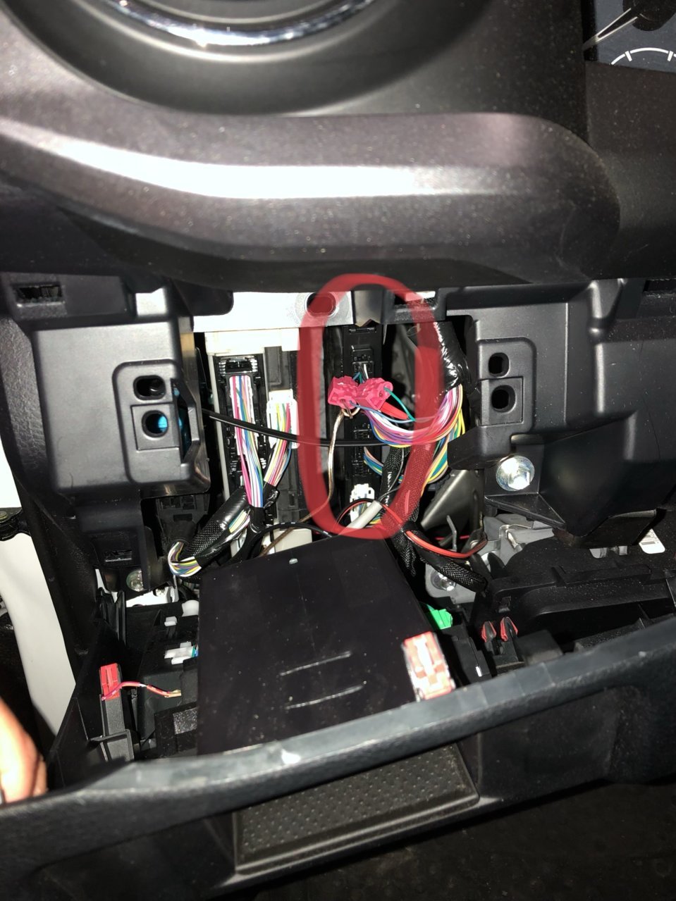

    Got mine installed yesterday.
    Not much to add to what has already been posted.
    When inserting the terminals into the connector, they have to be oriented correctly. Rotate the wire until you find the spot where it slides in easily and locks in place.
    I added wire loom to protect the wires.
    I also did the speaker upgrade at the same time. https://www.tacomaworld.com/threads/premium-audio-upgrade-for-less-than-250.510424/
    Many thanks to the O.P for figuring this out!
