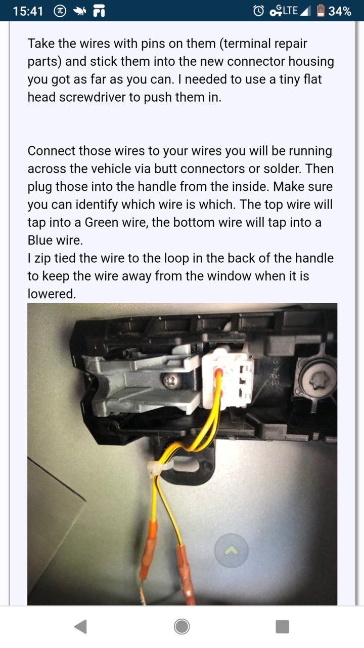

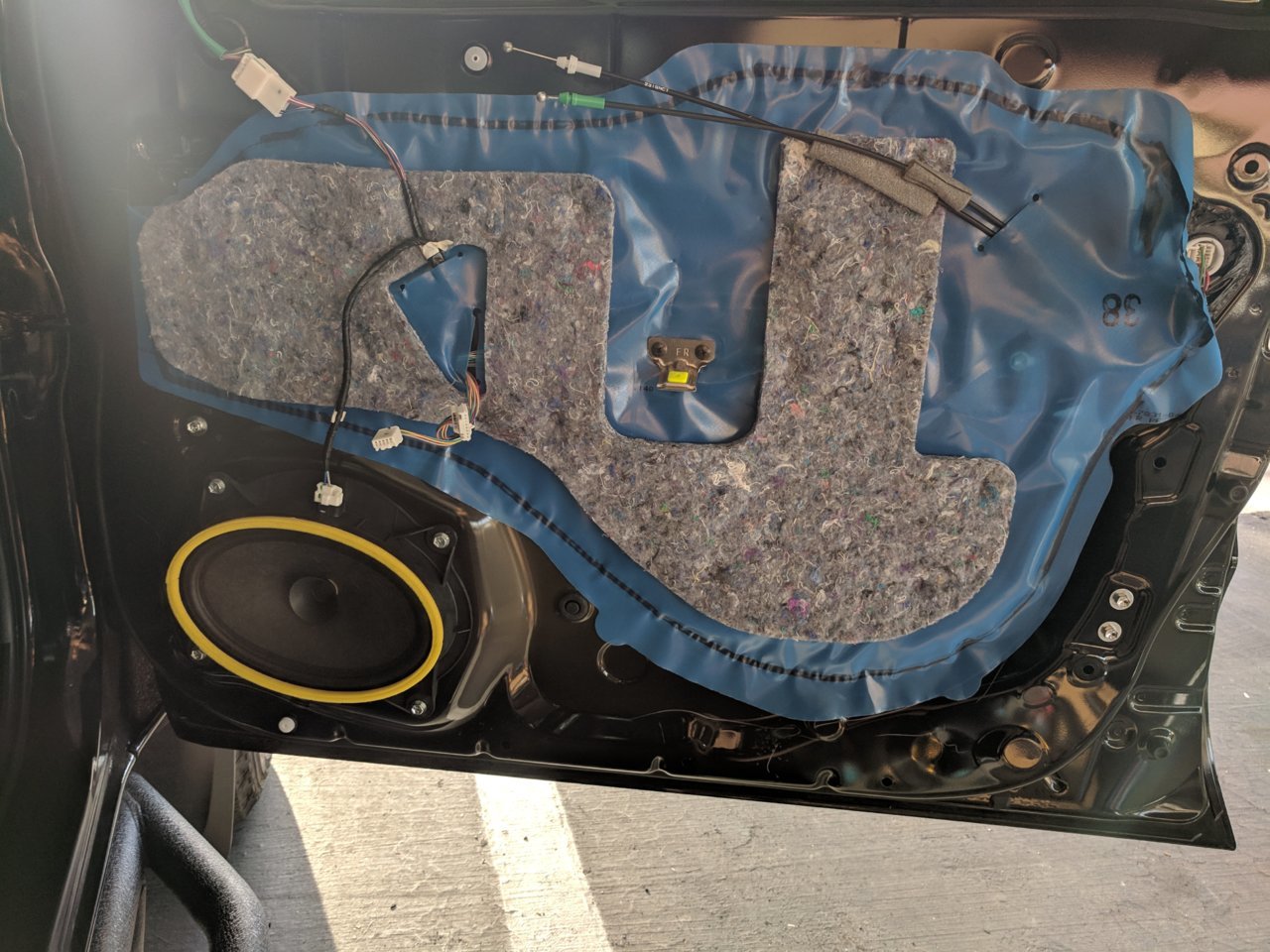

    Ok, need some tech support. Picture of the place in the instructions where I'm stuck, and picture of my door. Trying to figure out if I'm tapping wires on the door, or replacing a connector with the one I just made. Either way I don't see the wires or connector I think I'm looking for. Some help? Nervous to pull stuff off or cut the wrong wires.

    The connector you made will plug into the new "smart" handle that you bought. You'll take new wires and connect them to the leads from that connector, and fish that wire through the door, into the kick panel, under the carpet to the driver side and then tap those wires into the green and blue wires of the driver door handle.
    Ensemble88[QUOTED] likes this.

    Ah. Hence all the complaining about getting them through the boot. Ok, gotcha :)

    You will need to pull back the plastic on the door to see the back of the handle
