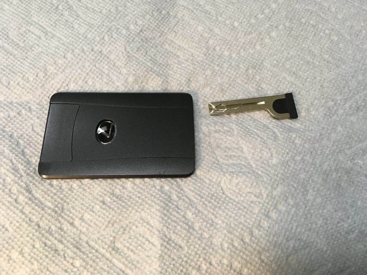

    Parts ordered.... did the Lexus Key Fob last year... there is a flat key that fits inside of it... when I did the mod, the key had to be purchased separately. Found both on Ebay.

    :thumbsup: Just ordered Both the Card Key and it’s flat Key. OP added the Flat Key Part# to the first post of the Key thread. Next I’ll do the door handle.
    https://www.tacomaworld.com/threads/lexus-credit-card-key-working-in-tacoma.445979/
